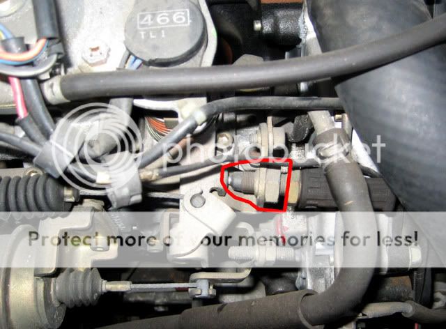

wonkanoby
Posts: 1729
Location: sunny catford
Re: Lumpy starting
Post by wonkanoby » Sun Mar 06, 2011 10:22 pm
Look down by pump at end of throttle cable
there is a cold start widget that pokes a rod to raise throttle speed on a cold start opposite it
it also does it when the a/c is turned on via another sensor
is it working

Post by campergeek » Mon Mar 07, 2011 10:47 am
Typical - frosty morning today, so gave it a try and it started perfectly. Aren't intermittent problems fun!
Anyway, had a look for the cold start widget. Is it the thing i've highlighted in the pic?
If so it doesn't move, though not sure how cold it needs to be to see it move, and a what point. I switched on the AC while it was ticking over and it still didn't move, so does that mean it's not working?
