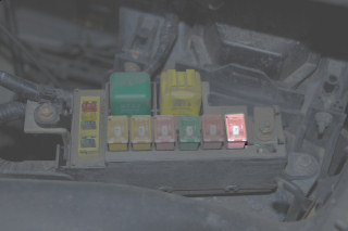

Post by Kevinrivett » Fri Dec 17, 2010 6:42 pm
Does anyone have a fuse box diagram they could send me?. trying to identify the fan heater fuse as its not working!!

Post by daveblueozzie » Fri Dec 17, 2010 6:42 pm
There is one on the members list
but the fuse under the bonnet is number 17 for the heating.

Post by g8dhe » Fri Dec 17, 2010 9:38 pm
For the fuses there could be one of three / four.
The controls are powered via this fuse;
The Fan motor itself is fused via;
and the servo's controlling the flaps;
also the Air Con. in the electronic version, also uses this fuse;
