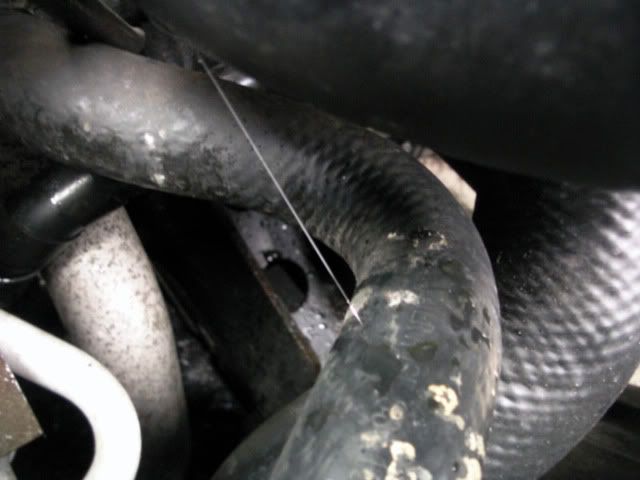

I discovered a little leaky hose today so before I sorted it (temporarily with amalgam hose tape) I thought Id take a few piccies so that new Bongo owners know what to look for and how hard a spot such a small leak is.Even though this is so small it still emptied about 15mm of coolant from the expansion tank in the time the Bongo took to cool off,think about it a few small journeys without a coolant alarm fitted and not spotting this was happening and there is potential for problems and costly outlay with the potential Bongo nightmare an overheat!
My Coolant alarm didnt go off I didnt give it chance to as I regularly check round the hoses and pipes for leaks,I am hoping that by posting this up that peeps know what to look for as the flow of coolant was so fine I had great difficulty seeing it at all.Amazing that such a small leak can shift so much liquid in such a short time!
Remember Peeps "Check your pipes and hoses" and as another precaution always have a quick look underneath it on the floor a damp patch is a dead giveaway!!
hope some of you find this usefull
