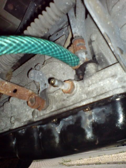

Just did my mates ATF, managed to get more out this time. Pumped it out as before, dropped the pan & filter (& some of the contents over me as the filter was fairly well gunged
 ), then disconnected the two hoses to the cooler
Once it had finished draining the residue from the hoses & the top of the 'box, I blew through the cooler pipework as before & then I stuck a piece of hose on the upper connection into the box & blew that through, got loads out of the lower connection. When I refilled it took about 7 litres.
