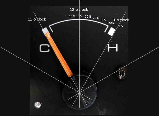

I've noticed that some owners think there's a case for, say, a Mason Alarm "Lite" which won't have such a big effect moving the engine temp gauge towards "H". To even consider this I'd need to make more sense of owners' comments about what their gauge is showing. I've prepared the picture below to provoke response (the postal strike means there's a lull in alarm sales so I have some time to spare!).missfixit70 wrote:As I've said before, it may be worth contacting Dave Mason on this one.
This, superimposing clock geometry on an image of the gauge, is my starting point for interpreting reports of "11 o'clock" or "1 o'clock". But, apart from the 12 o'clock position, I know this is not what most people mean. Both "11 o'clock" and "1 o'clock" are clearly thought to be much nearer the center. So where exactly?
My suggestion would be to forget the clock face as just adding confusion. Regard the centre as "50%" and "H" (the very highest edge of the markings, where my 1 o'clock line is) as 100%. The "normal" for an unmodified gauge is presumably around 40-45% and with an M-alarm is ... what ... 75% ? 90% ?

Re: High Mason Gauge reading
Going by your scale Dave, mine sits at about 55% as normal running temp & maximum is about 75-80%.
R.E the above scale mine is (general running) Around the 60% mark. 75% at a constant 65, dropping down the 55% mark above 80MPH.
Mines the same......missfixit70 wrote:Going by your scale Dave, mine sits at about 55% as normal running temp & maximum is about 75-80%.
Dave
mine is normally about 70-75%, going up to 85% on long hills
Mine sits at 70-75% in normal driving. It drops below that if stuck in traffic idling. It goes up to about 85% after pulling off the motorway, or on long hills. When the van is restarted 5 to 15 minutes after it has been running at normal operating temp, the alarm will peep for a few seconds with the gauge at about 85%, before returning to normal. Driving hard (highish rpm) surprisingly can result in lower readings: close to 70%.
Mine hangs around the 85 & drops to 60/70 either down hill, town drive, or idling..
The trigger's set for 5, & when that top hose went last October 08, the alarm pipped at 90 & screamed touching the hot box!
mines sits at 70 most of the time, downhill it drops to 50 when theres no engine loading.however i have got a large area on the rad thats cold so im putting a new one in this weekend to see if it drops down as towing the caravan causes it to sit a lot round the 90 mark which is too high for me.
