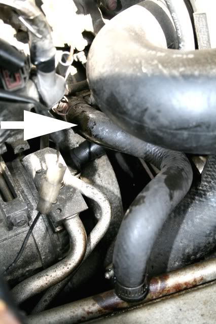

Found the offending hose is this 15-185 from coolant schematics ?
seems accesible enough for even me to have a go. Any tips?
Always be ready for a Top Up!
Re: Bost hose baz
Post by missfixit70 » Tue May 18, 2010 2:09 pm
Looks like that's the current major offender, see this thread - http://www.igmaynard.co.uk/bongo/forum/ ... =3&t=39683 I'd think about getting them all done asap as that's the second one that's gone :(

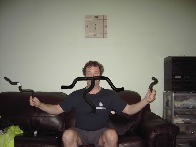

Got 4 hoses from shop and bost one from mazda.
What you reckon now?
Should i change burst one then bleed and take to garage for rest.
Change all ive got at once, bleed and hope for best [doing on road outside flat facing down hill]. :? :?
Or :wink: Do burst take to bash get volunteers to change rest one at a time and do bleed demo after each[ for video to benefit all]???
