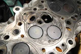

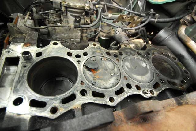

Post by timorr » Fri Jun 17, 2011 8:36 pm
As some of you might remember a couple of months ago I had the big head gasket job done. Big investment of over €2000. Parts shipped to Ireland from UK €1000 and work to strip and fit €1000.
So you can imagine how I feel when even before getting 1000km out of the new work, I am pulled over on the side of the road with steam PUMPING out and the sound of a cement block in a washing machine coming from under my seat.
Garage that did the work have towed it home and opened it up...and here is what they found!
They are saying it was the fault of the parts supplied. What do any of you guys think. What am I looking at here. I have lost trust and hope and do not know who to chase up on this. The garage fitter or the company supplied? Or is this just an act of an angry God?
Any help or advice please [-o<

OUCH!! dropped a valve!! worst case scenario, new piston, head and at least 1 valve, its parts suppliers problem, was the head supplied as complete/built?

Re: What the feck has happened now (photos attached)
Post by Northern Bongolow » Fri Jun 17, 2011 11:41 pm
i know nothing me but, in pic 1 of the head it looks to me like the area betwwen the valves has got really hot and melted towards the piston/chamber,this has damaged the seat,and snapped the valve.
looks like the heat came first then the damage was done.
like i say-----i know nowt me, #-o .
Post by The Great Pretender » Sat Jun 18, 2011 1:34 am
Northern Bongolow wrote:i know nothing me but, in pic 1 of the head it looks to me like the area betwwen the valves has got really hot and melted towards the piston/chamber,this has damaged the seat,and snapped the valve.
Wouldn't there be a water way between the exhaust valves? If so it could be a casting fault to fail so quickly. Bu**er anyway. :( :( :(
I thought thats where the snapped valve head had been pushed up and 'punched' a hole in the head, given the close tolerances i'm amazed it hasn't smashed the piston to bits, you'll probably find you have a bent con-rod, its the only thing that can 'give', (that said just looked at pics again and piston 2 is coming up flush with the deck?? assuming the bores aren't destroyed or damaged then the engine isn't written off by a long shot, i've seen and rebuilt one (and i'm not a mechanic) that suffered similar damage.

francophile1947 wrote:Did the garage fit a new cambelt when replacing the head, because I don't think they should ever be re-used - maybe that failed :?
I'd have expected the other valve in the same cylinder to have been damaged as well John.................
Looks like a faulty component to me - I feel for you (not that that's much of a comfort!)
I wonder if the glow plug in that cylinder is still intact - I've seen one fail and the centre part drop into the pre-combustion chamber - it could go from there into the cylinder - it's right below the pre-combustion chamber hole.............

Post by AlliDelta » Mon Jun 20, 2011 12:53 pm
You have 2 damaged valves, which says to me no fault on the parts. If the head has recently been fitted and on 1st run the damage happened I'd sugguest it has been re-assembled out of timing and on starting the valves have bashed the pistons. Either way it's unlikely you would have 2 faulty valves.
