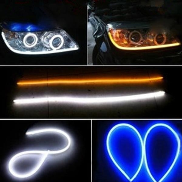

Thats it exactly, not sure about drilling the lights though.
I'm going to split the lens and fit them so they look like this.

Yeah Stuc has done it by heating the headlights and prising them apart.
Flexible LEDs on their way.

Have you a link to the led's you are going to use, they look good.

Hi Stuc,
This is what I've ordered - for £4 its worth a punt I thought.
http://www.ebay.co.uk/itm/250943608154
I'll do some pics and let you know how I get on 8)

I had them on my last Bongo, they were good but didn't last that long, may be ok inside the lights. I've also got them on the back as foglamps.

Yep all done
I have upgraded the whole set up now, with led sidelights, Osram night breakers and the led drls have gone inside the headlamps nicely.
Just need to think of a way to wire up the drls, either to the sidelights or do I put them on a separate switch that's the decision.
