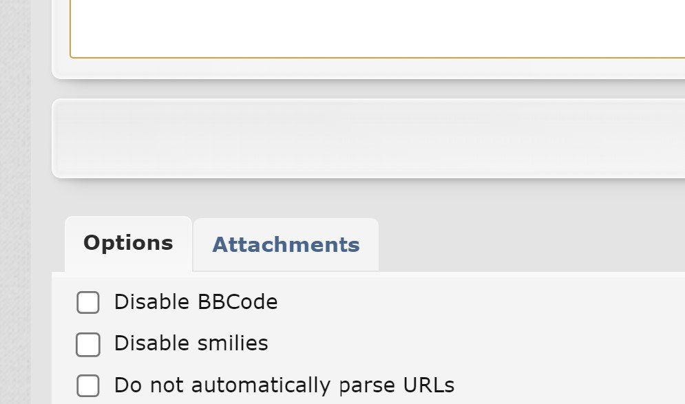

If you want to add images then look down below the text input area and you will see "Options" and "Attachments" Take attachments and then
"Add Files" select the image and choose "Place inline".

To add a picture;
Open a reply, below the input area Click "Attachments", Click "Add files" from your machine/network, click "Place inline" the code will appear in the input area. Click Preview and you can see what the post looks like before continuing the text or more pictures.
