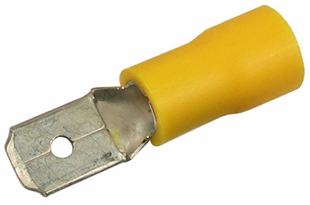

I'm sure there probably is but I've never seen a specification for the fusible link other than "1.25sq".
If we assume that this is 1.25sq mm than that is equivalent to 16AWG or 17swg wire which is rated for 25 Amps continuous carrying capacity.
Now if we look up the common glowplug used NGK Y-701 the spec given is http://www.ngk.com.au/glow-plugs/techni ... plug-types
Which doesn't specifically say what the current drawn is but indicates that peak is about 18Amps (each) and it settles down to 8Amps (each) so we could be looking at around 32Amps.
So it would appear that we would be in the right ball-park for a fusible link to be rated at 25Amps meaning 16awg wire, these links are designed to blow VERY slowly taking several seconds to reach melting point - unlike normal fuses which are designed to heat up and melt in the order of 100's of milliseconds.
So I think I would look to use a 2-3" length of 16AWG or 17SWG copper wire (insulated, non-flammable) if making it myself. Possibly replacing the connector with a Yellow bullet type connectors which should have an adequate current rating, Blue coloured connectors would be a better size fit for the wire but I would be a little suspect of there current carrying capacity.
If anybody has details - dimensions of the existing connector it would be helpful, not having a diesel myself I can't go out and measure it!

Yup no problem, be nice if we can find a suitable matching plug for the end of the link then no need to change any existing bits.
If anyone can get a photo of the connector that the link plugs onto it would be helpful, I'm wondering if its a standard spade connector, if so then its just a question of what is the width of the blade;
