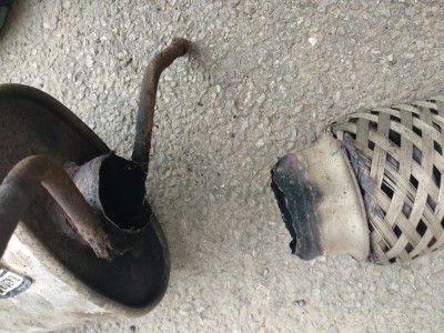

I knew my exhaust was blowing, when I looked round the vehicle as a bit of a pre mot check I found a little hole on one of the joins. That got louder whilst we were away and I came back to find it has completely detached!
I had ordered a mid section to replace it whilst I was away.
Just started the job today and am pretty appalled at the condition of the rear two bits. I think the front section is still original by the looks of things but I replaced both the mid and rear sections in May 2017. At the time the two pieces cost me £102.
I'm now at the point again where I need to order the rear section as well, as it has a hole in the top :(
Is only 3 years really to be expected? Anything that can be applied to stop the new ones deteriorating so fast?
Both pieces were klarius before from eurocarparts.
I'm trying to avoid buying the same again but they are handy for quick parts.
The centre section I have bought is a Regal and looks somewhat better but I wouldn't hold too much hope.

Hi, I can empathise fully. I bought my old van just over three years ago and on my way back from our first trip the rear exhaust broke at the bend as it goes over the axle, and I had to remove the rear section and limped home sounding like a tractor. I decided to replace the mid and rear sections myself also replacing all rubbers and bolts costing me approx £120-£130. 3 years down the line and my exhaust has got noisier and noisier to the point I thought I need to get underneath to which I found the seam along the rear box was split with rust and blowing like heck, I ordered the rear section for £66 and all done. I use my van most days although very short journeys so the rear exhaust is obviously going to suffer as it never really gets that hot, apart from when we go away. I'm quite happy replacing rear box every 3 and hopefully mid and rear every 6 years at those prices, we will see. Mine is 2.0 petrol auto btw.

It does seem to be false economy. They seem to fail on the welding. The main flat parts seem like new. I wonder if a bit of high temperature paint would make them last a bit longer?

The main enemy is condensation due to short journeys , many moons ago we used to drill small holes in the exhaust and ring it with a weld .

It probably doesn't help being a daily driver. We use it all year round. In normal times my wife uses it to drive to work and back (maximum 15 mins) but also drops my son off on her way (there and back) which involves switching the engine off after only a few minutes.
It does get a good run a few times a week as well though. Strange that they rot on the top first, but I suppose any most air rises and perhaps condenses on the top?
