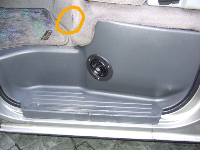

The air intake for my heater is in the vertical bit in front of the passenger seat, you can just see it circled in orange in first photo. Heater outlet is in the centre of engine cowling pointing in to rear of the van.
I think part of the reason for taking the air from inside the living area, besides not drawing in exhaust fumes, is that it is drawing in already heated air so doesn't have to work as hard as if it was heating up cold air so saving fuel..........I don't know how much it will save though, can't be much.
