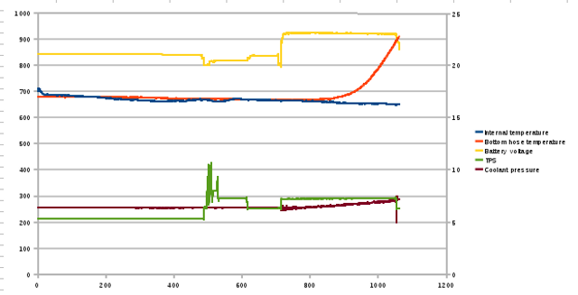

I've got the arduino logging to SD card. Performed minor brain surgery on the Bongo this evening, including tapping off the TPS voltage from one of the ECU connectors. A couple of dozen zip ties and a meter or two of electrical tape later, here is what I've got...

Hi Matt, did you get my e-mail? Have you thought of selling this as 'Pop Art'?Driver+Passengers wrote:I've got the arduino logging to SD card. Performed minor brain surgery on the Bongo this evening, including tapping off the TPS voltage from one of the ECU connectors. A couple of dozen zip ties and a meter or two of electrical tape later, here is what I've got...

I did get it, Peter - I'm just cogitating the permutations...peterrc wrote:Hi Matt, did you get my e-mail? Have you thought of selling this as 'Pop Art'?
Peter
The graphs are cool, aren't they?!

Can you get the scaling correct? I'm wondering why the battery voltage is dropping when you accelerate, where is the load coming from?

Engine was not running, I was checking the TPS voltage with a multimeter as my mate tickled the peddle - I did not have a read out on the arduino itself at the time, we were just checking the 12V inputs were being scaled down correctly. We heard a buzzing with the throttle somewhere around half way down, but could not locate it - no doubt linked to the voltage drop. Good spot - I'm not sure...Rhinoman wrote:Can you get the scaling correct? I'm wondering why the battery voltage is dropping when you accelerate, where is the load coming from?
I'll need to do a couple of tests to calibrate the scale, but I'll try zooming in on that section and see what shows.
Edit: you can see three levels for the battery - corresponding with key position I, II and running. The initial drop might be glow plugs, then some additional load once they're out - not sure. You can see the same sort of the thing on the TPS voltage - one of the levels corresponds with ignition off/TPS unpowered.

if cold matt the glowplugs come back on occassionally until the engine is deemed warm, unless the revs rise above 900 if i remember right, above that they turn off, if the revs drop, like at the traffic lights they come on again then when warm the egr will be activated.
knowing how your throttle is set up this could be your fly in your soup mate.

Northern Bongolow wrote:if cold matt the glowplugs come back on occassionally until the engine is deemed warm, unless the revs rise above 900 if i remember right, above that they turn off, if the revs drop, like at the traffic lights they come on again then when warm the egr will be activated.
Glow plug relay is already near the top of the list to sample.
