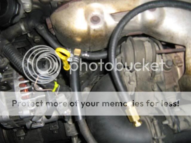

I have made up my own bleeder hose, will see if I can get some pics loaded for toehrs to see, hopefully this bleeder should work, will keep you guys/girls informed.

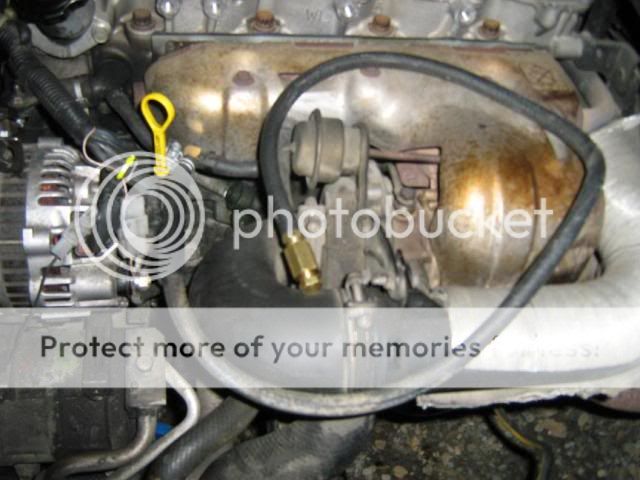

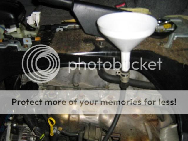

widdowson2008
Posts: 1703
Location: N.E.Derbyshire
Re: No bleeding hose
Post by widdowson2008 » Tue Jun 22, 2010 12:46 pm
mrdeano asked me to post these pics (not necessarily in the right order) of the current state of play. I also received the following email:
Gidaye Steve
Well here is what I am going to be bleeding the bongo with Wednesday evening after work.
Would you somehow get them posted for Helen to see plus also Ady please, as I haven't the time to go loading onto photo bucket etc.
If they are worth posting on Bongo Fury, please do if it would help any one else.
I still have to grab another hose clip for the brass bung I have rigged up, I won't bleed the Bongo until I am satisfied I won't get any pressure leaks when I am finished.
It should tuck away when I have finished with it along the chassis rail somewhere.
As for Bongonads, he is a retired garage owner from the far north, (Whangarei) area.
We have communicated and I'll also send him these pics.
I've tried his way of bleeding which is to bleed from the temperature sensor, that would be okay if you haven't completely drained the coolant system, usually when the radiator is drained, there is just over the same amount (plus) of coolant left in the system. I get about 5 litres by draining the system,and Ady has informed me they hold about 13 litres. I have managed to get about 11 litres into it by priming the coolant through the heater system, but there was still air in there so have adapted this method with my own bleeder hose.
Anyway I really appreciate your help,

Post by Northern Bongolow » Tue Jun 22, 2010 3:39 pm
deano,
just a little warning note,when you get going with the actual bleed,watch you dont rob the turbo of its coolant,just go gentle.
certainly looks like thats going to do the job.
in your thread you mention the 13 litres capacity,dont get to hung up on that,ive bled about 20 different bongos,and unless your going to turn it upside down your probably not going to get anywhere near that to come out,or put that amount back!!best ive done is 11 litres out.
most when bled only appear to take in another litre of fluid.??the only way to be sure the air is out is to bleed it,get the both heaters blowing hot,the bottom hose HOT not warm,hot means,working hands can hold it for no more than 10 seconds(stat open).
