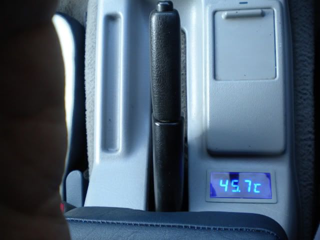

Went to fit Nigels (nigelgibson) Sure unit today. As Jamie has said, top hose metal stub is a b****r to fit and tighten a Jubilee clip, but a bit of Anglo Saxon helped the job along.
Was concerned that the Jubilee clip would damage the sensor as it wrapped itself around, so what I did was to tighten the Jubilee onto a 5mm screwdriver first. This 'formed' the clip and the sensor is firmly held in place. Would recommend this to anyone fitting one.
Before we fitted the sensor, we tested the rig in a kettle of boiling water to see if it was reading there or thereabouts, and it was.
Nigel has 2 sensors so we tested them side by side. Both channels 1 & 2 read correctly.
Fired the engine and watched the gauge. It did exactly what was expected. Got the reading up to mid 80's and felt the bottom hose. HOT.
So this unit seems to work fine.
Not a TM-2 which has audible alarms and a low coolant sensor (my preference if funds allow), but if funds are short, then this has got to be the next best thing. (and that is my view only - others will disagree)
Putting this big so Nigel HAS to comply. He promised me some data. :lol:

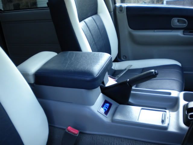

A big thank you to Jaylee for finding this gauge and for all his work behind the scenes validating it for the benefit of all.
Likewise a big thanks also to Steve [widdowson2008 ] for his help in fitting mine today ! He did the mucky bit , fitting the probe, whilst i fitted the gauge and wired it up. Believe me i got the easy bit !
The gauge seems to be working perfectly so far but i will provide the info Steve wants to further the field test info already gathered.
Ironically after a near 3 week wait for the longer probe /sensor to arrive i fitted it in a place whereby the 1m probe was adequate.
Anyone with no space left may want to try this , a bonus being the frame of the gauge is a perfect match for the bongo grey trim.
pic 2 is view from driver's seat - i put gauge upside down as i want to read it whilst driving.
