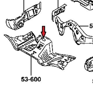

by jaylee » Thu Aug 11, 2011 12:26 am
Just in case there is a big rubber grommet here.. (Red arrow.) you can use below the glory/cubby hole for a more direct route, if need be??
... But it's a ruddy fiddle to get anything through! Good luck Nigel!!
