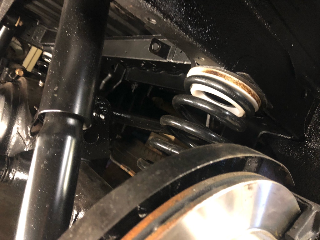

Does anyone know where to source the rubber part that goes between the rear coil spring and the cup on the suspension mount? Getting a small bit of rust addressed and these rubbers are badly perished.

I did in the end - I got two from a breakers in the UK but they were only marginally better than the ones I had already so I suspect to need to replace them in the near future.
https://www.spaccer.com/ Will make a custom mount but involves raising the van slightly at least. These are pricey too.
I've actually sourced a perfect fit shock mount from a russian vehicle, which I bought on ebay through an instagram contact - I've just asked him now if he's any more to sell and will post the link if he does. These are a perfect fit but also raise the ride height slightly. These cost me about 45e including shipping for a pair. I've not installed them yet but I have a spare set of springs to measure against an they're perfect.

Having some made atm from mdpe for £75 it seems that the Kia sorento rear spring pads would be a perfect fit without the extra lift part no 55131-3E000

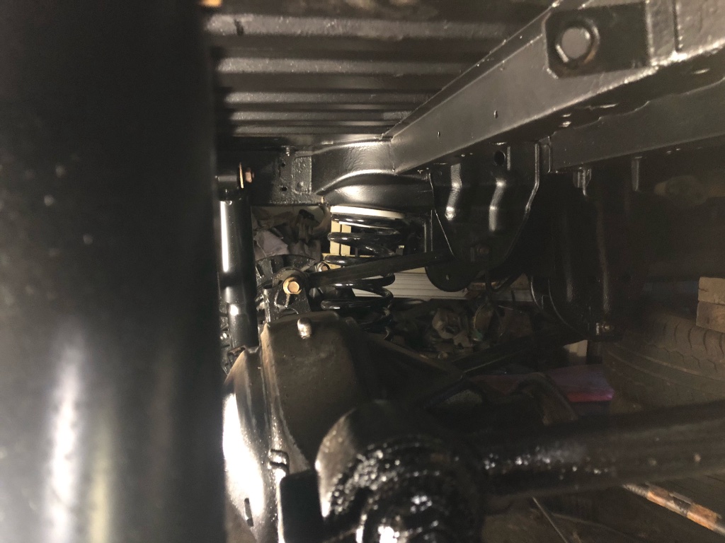

Picked them up today and now axle is back in just a million other things to sort now
