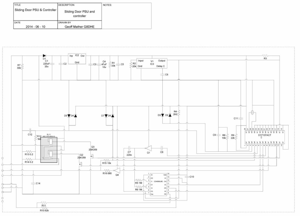

Hi guys hope you all keeping safe,
Please does anyone know how to test the sliding door contacts on a 1996 bongo please using a multi-meter, or any other methods.
Many thanks in advance
Tony

You do realise that its a small 8-bit microcomputer controlling it ?
What exactly is the problem your having ?
Geoff

Post by turfite9999 » Fri Mar 05, 2021 11:31 am
Hi Geoff thanks for the reply,
got all central locking working but the soft close not working, does 96 Bongo have soft close? I have changed motor at bottom of door.
Thanks
Tony

Post by g8dhe » Fri Mar 05, 2021 12:01 pm
Yes provided the door contacts have all 5 positions fitted then it should be soft-close, if it only has the 2/3 door locking contacts fitted then no!
For the small retaining clips speak with BongoSpares is normally best solution or find someone breaking a van locally.
