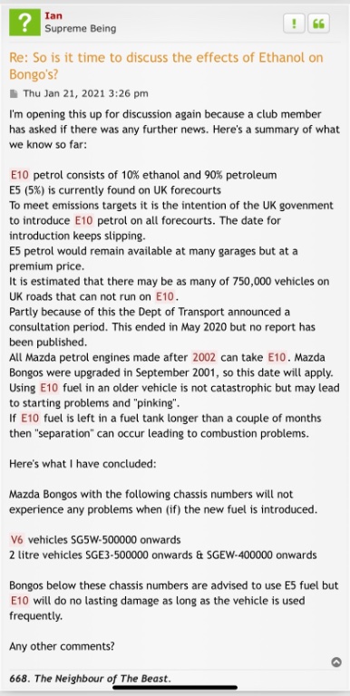

Does this supersede this regarding V6s now? Our chassis number was ok based on the previous info (see attached pic) but now I’m not sure?

Post by Ian » Wed Aug 25, 2021 7:52 am
The latest information is correct and supercedes the conclusions reached back in January. V6 Bongos should continue to use E5 fuel where available. This is because, unlike 2 litre versions, no changes were made to the engine etc in 2002.
