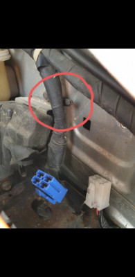

I also can't get the fog lights working, had a good old tinker yesterday and and confirm that the switch and the relay are both functioning. Bulbs are fine but no power getting there.
While digging around the relays I did notice an earth that had been cut was wondering if that could be the earth for the fogs?
On the wiring diagram you put up is the far left hand fuse a free slot the existing back up slot one.
