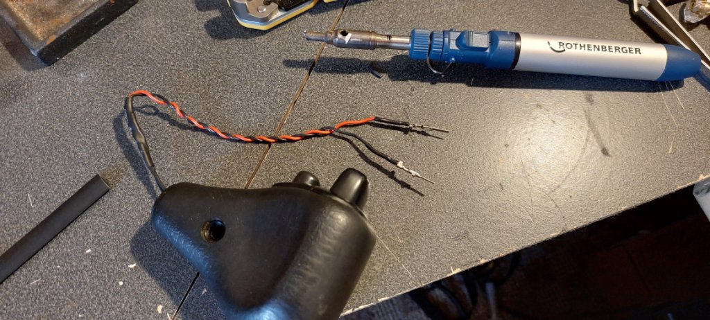

Re: Gearstick Hold Switch
Post by -Matt- » Fri Apr 15, 2022 6:51 pm
Nothing wrong with the damn switch :roll:
After cutting the wire up to the selector knob to fit a different switch that I had, I put the two wires together, and nothing happened.
It's actually a section of wire down to the connector block. So I've carefully removed the pins from the block, replaced the section of wire, fed it back down the cable run and reinserted back into the connector block.
I now have working Hold!
You can see the pins in the pic, the wire was just something I had of the same gauge.
Oh, I managed to salvage the top of the button and glued it back on, so it still looks original.
