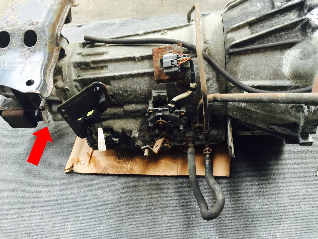

The connector for all the main internal items comes out on the offside of the gearbox, might be worth having a good look down and follow the cable to the connector its roughly in the middle (not the red arrow!)

Thanks very much for the info/pic, I’ll have a deeper look and check it out.
