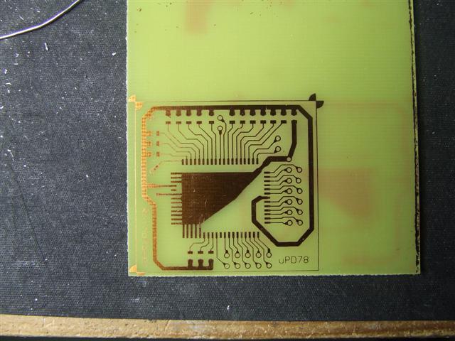

A little more progress to report.
The processor was removed from the PCB some time ago, now I need to make up an adapter to fit into the PROM programmer to read it. The first part of the adapter is a PCB to mount the processor on, this was etched this evening:

Rhinoman wrote:A little more progress to report.
Not got a clue what you are talking about but I agree 100% :shock: =D> =D>

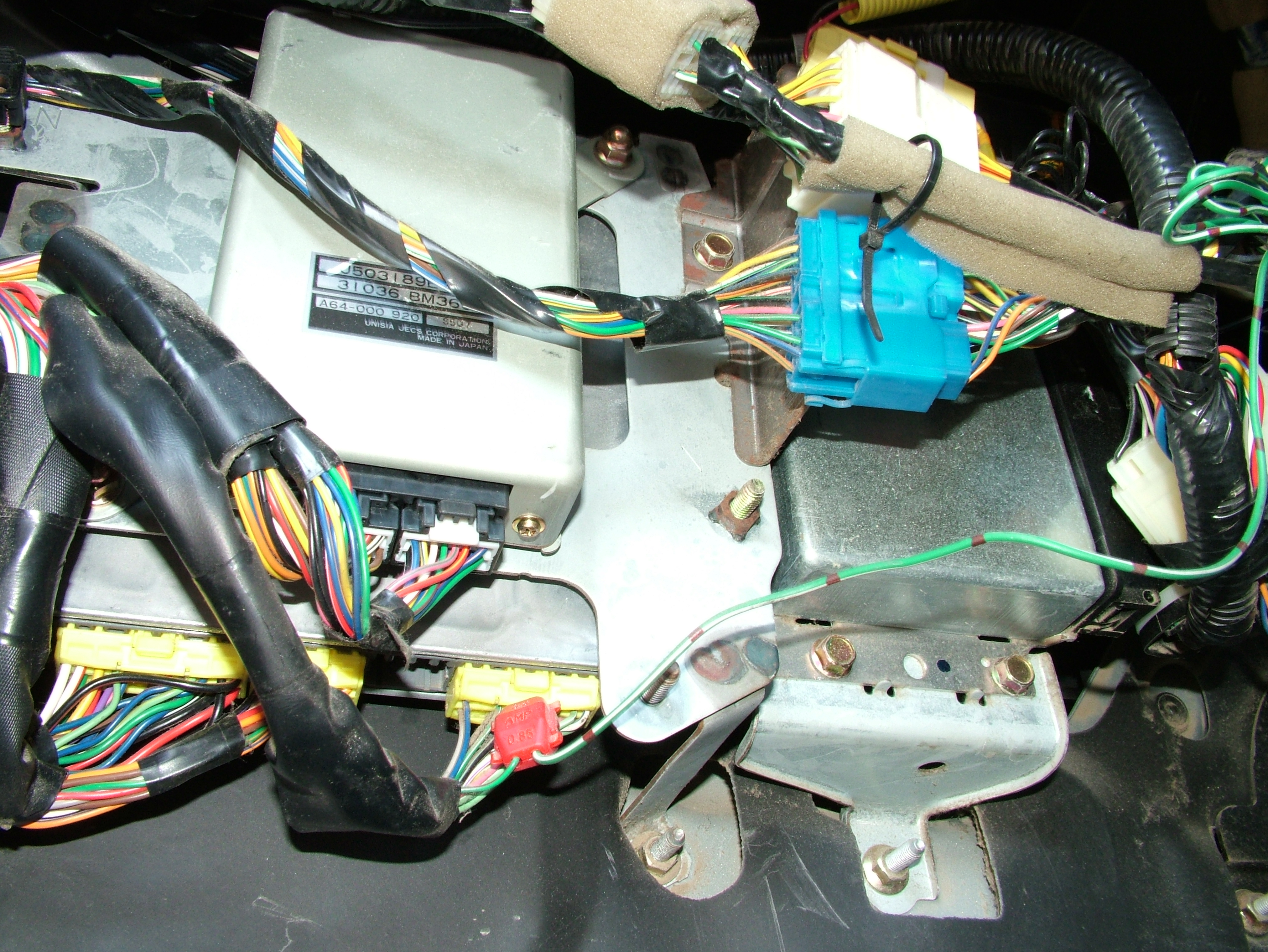

I have the service manual here and it shows the ECU to be behind a cover, it doesn't give any clue as to where that cover is on the vehicle. I don't want to start dismanting it further than I have to so where is it chaps?
James
1995 Ford Freda, 2.5TD, auto, AFT, side conversion.
Posts: 10705
Re: ECU information required
Post by g8dhe » Mon Mar 15, 2010 6:54 pm
Down in the passenger footwell behind the glove box, click for bigger images;
The unit on top is the AT board on the V6, I think in a WL-T its on the main board so you may not have it at all.
the ECU is the one behind. Depending on the type you may have 2 (2.0l) or 3(WL-T / V6) connectors

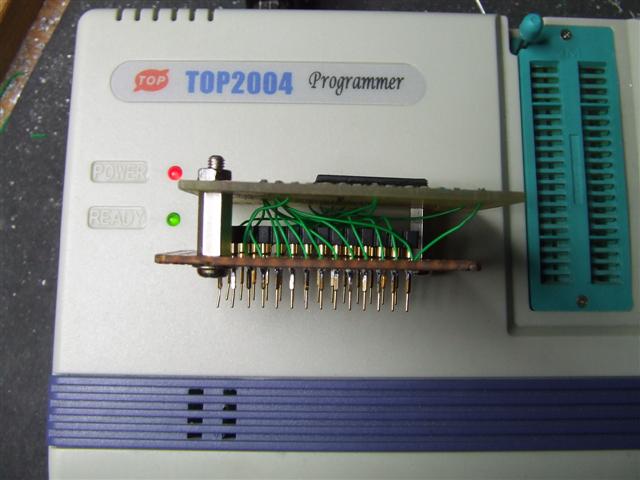

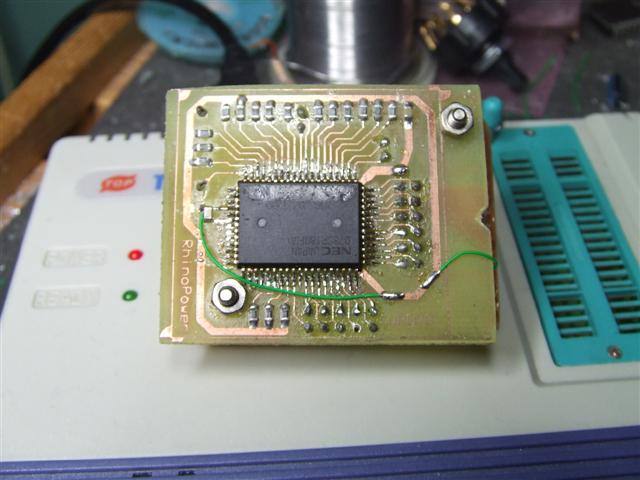

Post by Rhinoman » Fri Mar 19, 2010 7:42 pm
OK, I made a minor error on the PCB but thats been corrected and the adapter is complete. The adapter consists of a custom PCB (etched in the kitchen while the girlfriend was out ;-)), a bit of old stripboard and some good old fashioned wires:

Post by Rhinoman » Fri Mar 19, 2010 7:52 pm
The all important binary from the processor:
http://www.rhinopower.org/ECUs/Bongo/docs/bongo.bin
In the unlikely eventy that anyone wants to look at this I would recommend a programme called FRHED (Free Hex Editor).
The binary is quite unremarkable, a little under 11000 bytes of code and a bunch of tables and data, all of which looks to be quite nicely ordered. No copyright notice either which is always good.
next stage is to extract the interrupt vectors from the binary and then run it through the disassembler to get something that is just about readable. Then I need to trace through all the circuitry on the ECU to determine which pin is connected to which function, feed that back into the disassembly and then try to make some sense of it.
