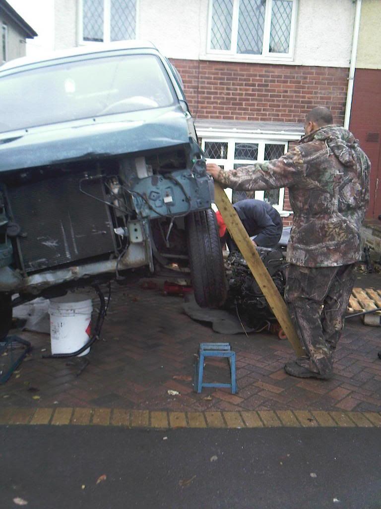

It's just that you have to lift the van so high, much more than axle stands and trolley jacks will allow............however waycar, I didn't realise that you weren't refitting an engine........you may have a problem lifting the van with an engine crane....HSS cranes only lift up to 500kg and won't lift the van much (been there done that!)
A mini digger should be good though to lift the whole van up. My new engine came from a write-off and we tilted the van over by about 45 degrees to slide the engine out.

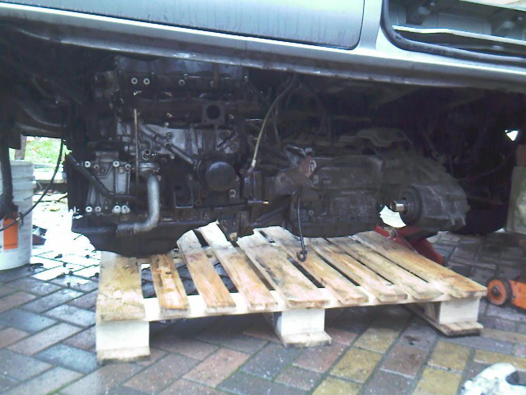

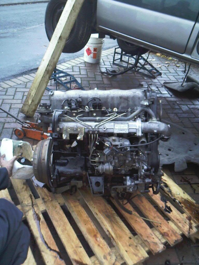

1. Get front up on ramps.
2. Jack up passenger side as far as poss.
3. Chock, put blocks on jack.
4 Repeat 3.
http://s215.photobucket.com/albums/cc23 ... o-0034.jpg
6. Using a pair of trolleyjacks, 4 people - including at least one the size of an ox, the whole lump can be carefully rolled out resulting in applause & cheers
