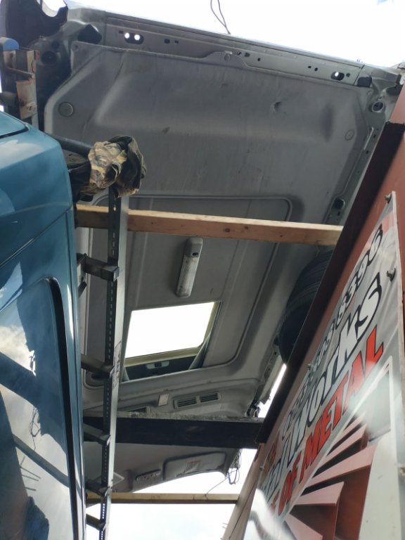

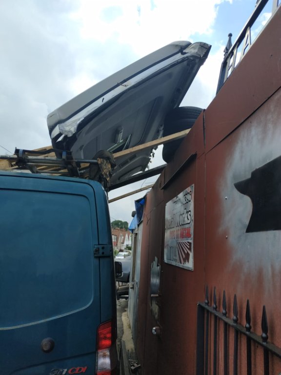

Hi everyone, I'm new to the forum and stuck with an AFT project. I know it's an old tread, but worth asking. My wife and I have a Mercedes Sprinter as a DIY campervan. We got a AFT with the old Bongo metal frame attached to the fiber glass top. That was cut at the wrecking place where we bought it.
As the original Bongo's frame is being trimmed and the roof of the Sprinter will be cut as well, in order to attached the AFT using a welder, I was wondering where the electric motors are located on the AFT to find out how far can I go with the trimming. Also, I couldn't find anywhere a 3D view to see where the mechanics/sliders are located too, and the electrical diagram of the wiring to hopefully put that to work.
I hope the pictures can give some idea.
Any information would highly appreciated.

The motors are at the rear of the top cover. It looks as though the roof is unopened so they cannot be accessed without activating the motors .
This can be addressed by connecting to bongo wiring looms . Otherwise best to open the roof by direct electrical means by such as connecting 12v to the "open" signal to the motors simoultaneously. The wiring diagrams will tell you this.
The controls are via the bongo ECU logic I think , so if you are not going to use this you may have to incorporate some home grown logic as there's limit switches . The ECU incorporates some safety aspects such as a timed warning sound initiated by switch in top roof, making you do a search of roof space before driving roof down.

Be warned don't overrun the motors beyond the limit switch positions if you decide to manually operate it you will end up buckling the Teleflex cables.
Circuits and internals of the computer shown on the diagrams. Motors are on the top surface close to the sides sides at rear under plastic pop off covers.
The control computer is no doubt now crushed as its inside the vehicle at the rear offside, all you will have is the cabling cut at the point where it enters the roof, There are 4 limit switches 2 at front(down) one at rear(up) and one halfway for safety check.
Never run one motor on its own or when one is removed from roof the two motors are synced by the pair of Teleflex cables, as each cable passes thru both motor mountings on the crown gear.

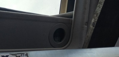

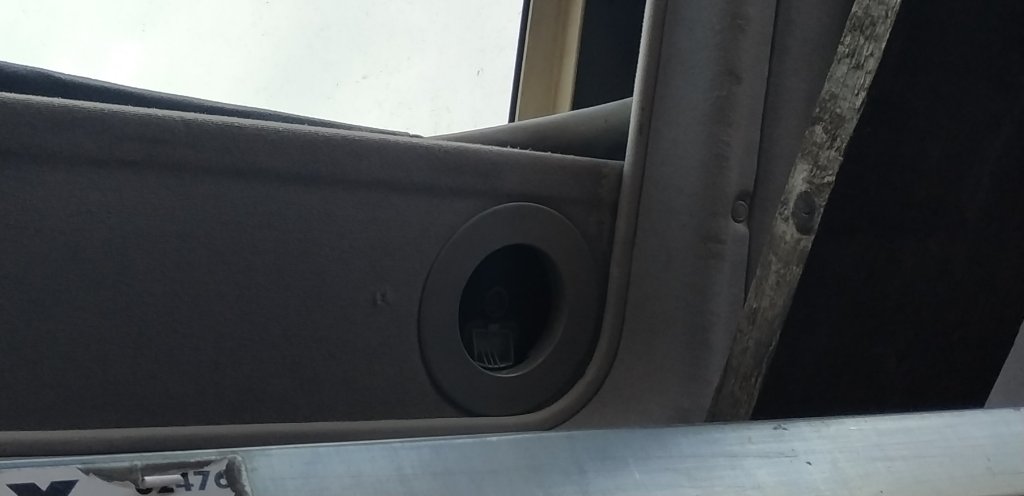

Hi g8dhe, thanks for letting me know, and you're absolutely right. I'm aware to never run one motor on its own. Now everything makes a lot more sense. The safety switches are key to keep the system healthy. Just one more question, what's the whole on the left-hand-side near the glass for? it looks like some kind of ventilation to me. You'll be able to see it on the first picture I've attached.

The hole is so if you have children sleeping in the roof you can reach up and shake a shoulder, should you need to wake them, as you can't open the hatch with someone on it.
I've also heard that you can use it to pass drinks up but that doesn't really seem likely or plausable to me. :?
Posts: 10948
Re: Squiffy Roof!
Post by g8dhe » Mon Aug 17, 2020 5:30 pm
and I do believe after you have drunk the drink you can also get rid of it down a tube thru the hole ;-)
Yes the small internal hole helps equalise the pressure whilst the roof is being raised/lowered :-)

I think this porthole only works for air (and beer) going upwards when opening, there is another vent at the small end of the wedge of cheese which exhausts air when closing.
