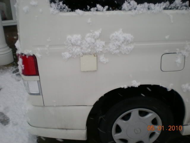

Heres a piccy of mine Ron next to the fuel filler Colin

Colin H F wrote:Heres a piccy of mine Ron next to the fuel filler Colin
Thats where I fitted mine.....It's been fine and I wouldn't want it anywhere else and defo better than running a wire in via a windod/door with all the risks involved.

Another advantage of fitting on the offside is that the cable isn't in the way of a side awning, should you use one.

stilldesperate wrote:Another advantage of fitting on the offside is that the cable isn't in the way of a side awning, should you use one.
SD
AH! very good point and one easily overlooked :oops:
SD
Not sure I get that one :? Coudn't you make a counter argument that says its better/neater if it allows a quick split off into the side awning as well as connecting to the van. Basically, link side awning to Bongo and link power supply too. I think (but not sure, if not then thats a down side) dreamwarriors comes in from underneath the Bongo, so sliding door and access is not obstructed, but check with him 8)
