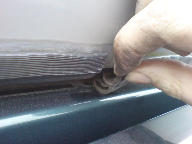

This is the bongo seal, not the best piccy, but it's sort of between two of the Justkampers ones, doesn't quite go out sideways but it's not quite central either

How wide is the "U" on the Bongo seal Kirsty? JK reckon the Vee Dub seal won't take much more than 4mm wide - the Vee Dub is a flimsy lid.

Difficult to tell, just had a quick look (was doing 3 other jobs at the same time
) & the seal itself bent a bit as I was manoevering it, I'd have to measure properly & possibly have a look at some samples to say.

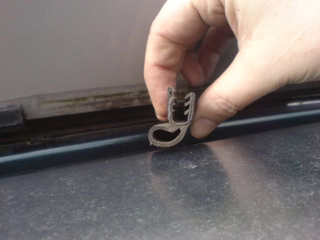

Re: Bongo Free Top weather seal.
Got a better pic today
it's about 30mm high & 12 mm wide externally & about 4mm wide, maybe just over, on the aft edge.

I had a look through the downloadable wall chart of rubber trim profiles of the company Helen linked to, one or two look close, I've sent them an email with a pic of the profile with sizes & a request for samples of anything they have that would do the job.

That's what I've always done with that company...pick something off their chart. Last time I went I seem to remember that they had a load of books of trim. They won't have something "Bongo Specific", so it's just going to look...or post a 1/2 inch piece...cover the gap with greenhouse tape...and, as I say...order a fair bit more than you think,and a rubber tube to slip in the hollow "squashed" section...your old one may not have had a joiner, but your new one will need it....I've done this job a few times. The new rubber may be stiffer than you imagine, so do the job on a hot day, leaving the rubber in the sun for a while, and fit and re-fit (shuffle) the rubber....it's easy to fit, cut , and find you've cut it short....
