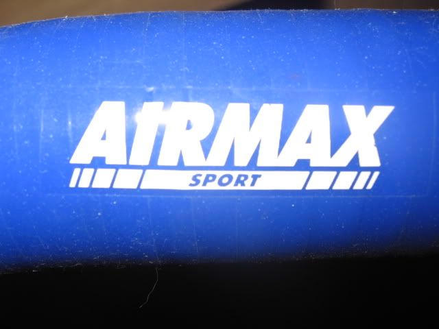

These are the hoses I've got ready to fit........
http://cgi.ebay.co.uk/ws/eBayISAPI.dll? ... K:MEWNX:IT
4.5mm wall thickness.

A few of things I have noticed from the pictures:
1) I have not measured the standard hoses, as touch wood mine are still working, but the Silicone hose looks thicker than standard, which would reduce the effectiveness of the hose clip, especially as it looks as if the fabric is like a mesh, (which is good in as much as it will make the hose more supple), but there is a lot of rubber to absorb and spread the clamping pressure.
2) The inside of the hose looks quite dirty, it is possible that there is lots of release agent used as part of the forming process, if this remains in place it will reduce the grip the hose has on the spigot, encouraging movement, and potentially leakage.
3) The inside and outside of the hose also has white dust on it, I would be concerned that this is a peroxide compound from the 'curing' process the Silicone goes through, it would be better not introducing it to the cooling system.
In case of both 2) and 3) I would suggest a good scrub with soapy water and a rinse before you fit the hoses.
Also, it is not recommended to cut off old hoses from spigots, as the knife can leave a nice leak path where it scratches the spigot.
(And fit some red tape over the clips, only kidding Donald!)

munroman wrote: 3) The inside and outside of the hose also has white dust on it, I would be concerned that this is a peroxide compound from the 'curing' process the Silicone goes through, it would be better not introducing it to the cooling system.
The white dust could be from the jiffy bag they came in, someone decide to burst open the jiffy bag, now there is fluff all over the place. :evil: I'll be cleaning them before fitting, thanks for the tip Derek, to be honest I would of just fitted them not thinking about the dust. :oops:
Tried one on the new rad, and it slipped on fairy easily......in fact easier than expected. 8-[
