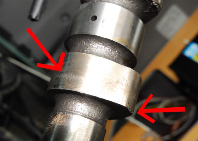

After enlarging the photo I think you hit the nail on the head.Northern Bongolow wrote:i know nothing me but, in pic 1 of the head it looks to me like the area betwwen the valves has got really hot and melted towards the piston/chamber,this has damaged the seat,and snapped the valve.
looks like the heat came first then the damage was done.
like i say-----i know nowt me,.
My theory is that the casting was faulty. I could be totally wrong BUT............
Circled is the waterway above the position that it melted. If there was a problem when casting (I don't want to go into how the hollow parts are cast) that isolated the highlighted portion from the cooling system you would have a sealed pocket. As the metal here is at its thinnest (expecting the coolant to remove the heat) you have an expanding superheated pocket of air ready to blast out as soon as the alloy reaches a soft state, hence the eruption.
This may have happened before the problem became terminal.
The valve seat could have at first been compromised allowing 'steam' that was unburnt fuel due to lack of compression causing the original problem.
Valve stems can become soft and it is possible it was trying to seal on the second journey before it cried ENOUGH and snapped. As that cylinder is then dumping unburnt fuel into the exhaust you get 'steam' or white smoke.

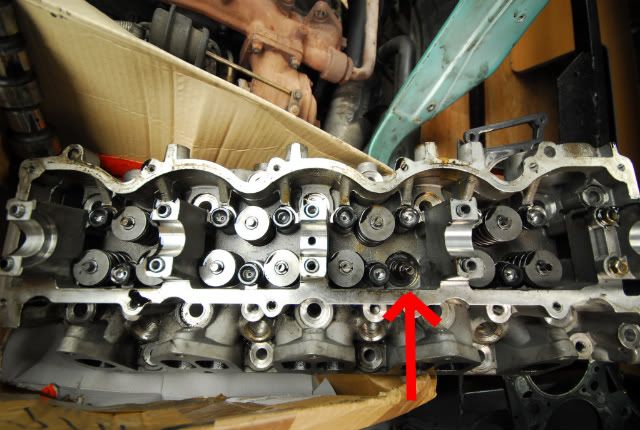

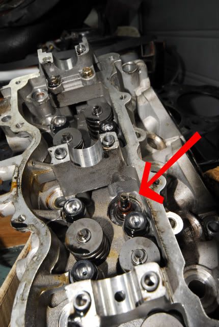

So...anyone interested in an update.
Waiting to hear back from the part suppliers now. They have all the photos as well as the ones below of the other side. Anyone got any more thoughts on what happened?
Re: What the heck has happened now (photos attached)
Valve retaining collett popped out and allowed valve to drop?
I.E. whoever installed the valve didn't make sure the colletts were seated properly ?
Where was the stem of the valve found? even without the head of the valve, the stem shouldnt be able to drop as spring pressure would just push it against the cam? assuming thats the scrubbing on the cam lobe in the picture and the mishapen valve guide?scanner wrote:Valve retaining collett popped out and allowed valve to drop?

Can you check the tightness of the spherical seat (rocker seat) opposite this valve?timorr wrote:
Reason for asking is that when we fitted a new head recently, we had a note through the post 24 hours after the head was delivered, to check the tightness because 'some' had been delivered in an 'unset' state.
If it IS incorrectly set, could this unscrew itself gradually? and in doing so, effectively cause the valve to work progressively lower in the cylinder bore and eventually smack the piston (and smash its head off)?

scanner wrote:Valve retaining collett popped out and allowed valve to drop?I.E. whoever installed the valve didn't make sure the colletts were seated properly ?
- dandywarhol
- Posts: 5446
- Location: Edinburgh
Second that - were the collets and spring retainer still lying in the cam cover?rita wrote:scanner wrote:Valve retaining collett popped out and allowed valve to drop?I.E. whoever installed the valve didn't make sure the colletts were seated properly ?
Collet has sprung out, valve dropped, piston had smashed into the dropped valve and cleaved the valve head off........IMO

There have been cases on here where built up heads have been supplied with incorrect valve clearances and or loose parts. Did the garage check this? I believe a tight valve clearance can cause this sort of damage.
If this is bollocks, sorry I am surmising what I have seen on here and my experience of petrol engines!

No - aint a load of bollocks - see the link a few post ago.Velocette wrote:There have been cases on here where built up heads have been supplied with incorrect valve clearances and or loose parts. Did the garage check this? I believe a tight valve clearance can cause this sort of damage.
We stripped the head back to get at the 'possibly' loose bits only to find they had been correctly torqued. However, the supplier was concerned enough to tell us to check.
That was the last thing that we done after fitting/springs/caps and collets...............Gave the top of the valve stem a Great Wallop with a 2lb hammer.dandywarhol wrote:Second that - were the collets and spring retainer still lying in the cam cover?rita wrote:scanner wrote:Valve retaining collett popped out and allowed valve to drop?I.E. whoever installed the valve didn't make sure the colletts were seated properly ?
