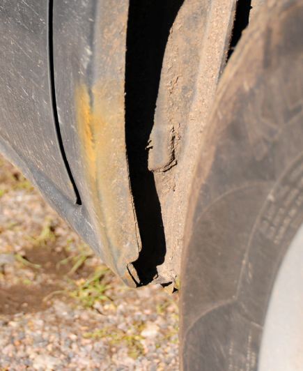

July 1995 tintop, been unprotected underneath untill recently, although it has a winter pack it lived in the south of japan.
Arches started to split at the seams, so had them done before it got any worse

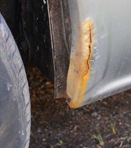

Right a couple of pic's of our old rust;
Decided to get them seen to before they got to bad.

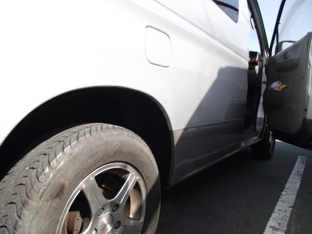

Mine (a 99 Mk2 V6 AFT) has no rust at all anywhere. Even the labels underneath were still visible so I assume it has had a dry life in Japan. Rustmaster did their stuff on it last year with a full coating and a guarantee.

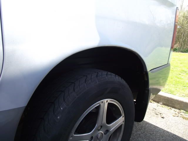

I dunno ste, i reckon the black ones do too...?!! For the age my arches are OK.. But i do have a little bubble/trouble about 2 to 3 inches back above the bumper line, passenger side! :roll: 8-[ 8-[
...& Stuc's could be the possible future of mine if i don't sort it! (Stuc's picture.)
:shock: :shock:
