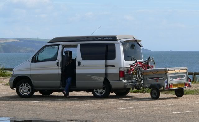

I've used it a few times over the summer. I have a small trailer and a bike rack (2 bikes) which I use together. I'm not towing anything like a horse box or a caravan so I can only comment based on my own experience - no problems at all.
As far as I can see, there are two possible problems (not unique to the Anker bar):
1. Nearside bumper fixing point weakness (an issue with the Bongo, not the towbar itself)
see here:
http://www.igmaynard.co.uk/bongo/forum/ ... oping+rear
2. The centre fixing for the Anker bar requires drilling through the floor section just to one side of the tailgate catch (hidden by the plastic trim). A spacer tube is inserted into the floor section and the towbar is then bolted through. If the centre mounting is missing, or if the spacer tube is missing, then the installation will be weak and prone to bending. The Bongo floor section is very thin wall steel and the spacer tube is essential.
I can't really comment on the problems that others have had with the Anker bar as I have not seen any photos of where it failed. But the two items above would be the first things I would look at. '1' is related to the Bongo, and '2' is related to correct installation.
As I said, these are just my own observations but I have had no problems with the Anker bar and I can see no major weaknesses with it. Having said that, for my own peace of mind I would like to see a photo of one that failed so I can compare it to my own.
