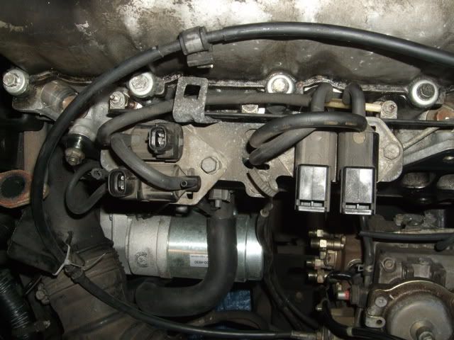

Sorry I don't have Photoshop and GIMP's not working so I'll just describe stuff on the photos...
To the right of the rightmost top intake manifold stud is a sensor, to the right of it is a bolt that I found to be loose. Any ideas?
The second rightmost bottom intake manifold bolt secures a small bracket to which a perished vacuum hose was found dangling.
To the rear of the two valves on the right is a double-tee connector. The right hand side of this was unconnected. I'm guessing the previous dangling hose goes here.
The lower left hand valve had two dangling hoses. One on top, one on the left side. Two connections hose stubs were found with nothing attached - one on the EGR valve and a plastic one on the air hose that runs from filter to turbo, which is still intact. Bear in mind that I'm blanking the EGR (and may remove it since it's off anyway).
I haven't scoured the forum/diagrams yet, so if anyone knows the appropriate plumbing layout or posts a link before I do...

Re: vacuum tubes...
http://lushprojects.com/bongopartsmk2/c ... 1of02.html
This confirms that the open end of my double tee should be connected to the metal pipe supported by the bracket secured under the inlet manifold bolt.
1300/20-300 is the EGR valve. 1312/13-341 is the "air funnel", though I appear to be down a check valve.
So the top connector on the front left valve goes to the EGR valve, and the one on the end of the front left valve goes to the EGR.
Can anyone say anything about the check valve in the tube that goes to the air funnel nipple? Again, I'm removing EGR so it doesn't really matter.
So I'm guessing that I've had no fast idle or EGR operation if the feed from the vacuum pump to the double-tee has been disconnected all this time. Presumably I leave double-tee disconnected, start engine and switch on AC - revs should go down - connect tube and revs go up. I'll try this out when it's all back together.

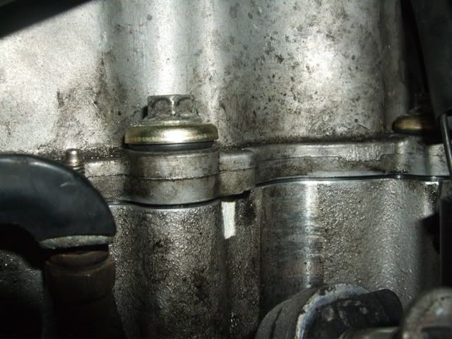

Rocker cover gasket finally arrived today, after ordering on 14th. One question: the new gasket is significantly 'taller' than the old one, and means that once I've tightened all the cover bolts to where I'm happy, the cover and head are not fully mated, as in the first photo below. Is this ok? Feels ok, but I don't want to over-do the bolts, or damage the gasket.
Made two EGR blanking plates from thin aluminium plate I had in the garage (2mm for the inlet manifold, 3mm for the exhaust pipe) and applied instant gasket and threadlock when fitting them both. One of the connections on the EGR valve is threaded, the other has studs - that gives you a pair of nuts and a pair of bolts for the plate that goes on the pipe coming from the exhaust. For the blanking plate to go on the intake manifold, I had to cut down the bolts to account for the loss of thickness having left the EGR pipe off. I wasn't sure about making my own but now I see them on, it's a piece of cake. Went a little heavy on the instant gasket, though.
Removed the elbow and large rubber hose that goes down to the metal pipe coming from the intercooler. Note: there's a 12mm bolt holding the metal vacuum pipe to the elbow. Cleaned out the inlet manifold, elbow and hose with boiling water and washing powder twice, scrubbing with a toothbrush on the end of a stick. Rinsed and dried with a hairdryer. Lost one of the hose clips for half an hour, and then called it a night.

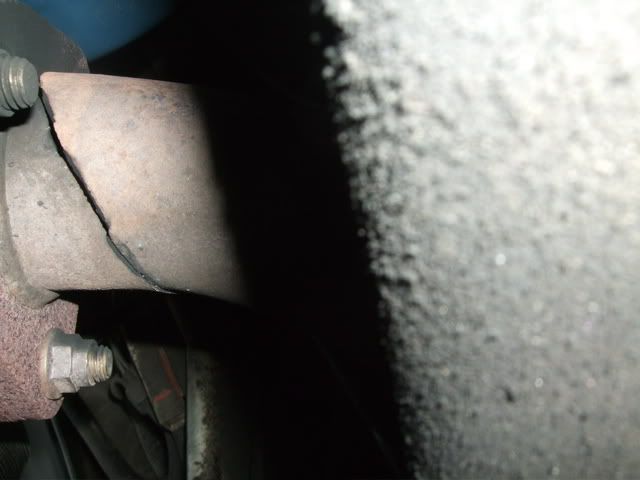

Exhaust blow needs done ASAP - the front pipe is cracked about 1/2 way round.

Yes, I have new mounting bolt seals. I was thinking about removing it to clean the gasket. It's a bit of faff - shouldn't be much more than an hour, though.Simon Jones wrote:Always wise to remove yourself from the engine before driving long distancesDriver+Passengers wrote: I'm somewhat spattered over the inlet manifold.
I don't have the torque settings for the rocker cover to hand, but you need to be careful not to over tighten it otherwise it may distort the gasket. Personally, I would remove it, give it a good clean & add a smear of gasket compound on the mating surfaces before re-assembly. Did you get new rubber seals for the mounting bolts? They will harden over time & may not perform so well once they have been disturbed.
Torque settings will be in the service manual (I have it) - my biggest problem is the (new) torque wrench appears to be 'stuck'. Bought it in March, may no longer have receipt. I know that's no excuse to be 'cowboy' about things...
Edit: I've just worked out how my torque wrench works. There's no way that 8Nm would seal that! I will loosen them though, clean the surfaces, use a little instant gasket and try again. I think I have tightened the bolts beyond specification, but certainly not beyond reasonable for the materials involved. Perhaps the oil has come from somewhere else... can't think where.
In the meantime, here's the crack in the exhaust...

definitely going to remove the rocker cover gasket again, inspect it for damage, clean it off, smear sealant and replace with torque to spec.
Then look for more splatter originating from elsewhere, perhaps...
