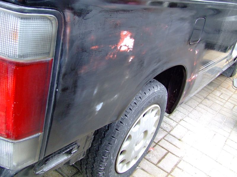

well they are all welded in --------.
inner arches all welded in to place, they went in very well and am glad i used the original panels off a scrapper, this allowed me to just trim out the complex shape of the rot to the end plates of the sills and the rear edges of the arches where the mudflaps mount and the little plastic splash pieces hang, the small panel under the rear/side vents suffered badly on mine and the bottom edge of both sides was chopped out and replaced, all this was then seam sealed with a good quality panel adhesive, then body schultzed for stone protection.
the inside of the outer skin above the wheel arch is fitted with a sound deadening strip of foam like stuff to stop the panel drumming i presume, this was easy to remove from the new part to be added to the old wing, however the strip inside the van side is a lot harder to get at and should have been removed, not removing this fully has led to small local fires when the new wing is welded in, these small fires have caused the panel to distort more than i would have liked
. this has led to a lot more work and time trying to get the panels to look right, this may infact be impossible or impractical for me to achieve working outside so i may have to just live with it.
anyone who has ever done this sort of thing before may say the secret to doing filler work is to keep it local to the job as you end up going further and further across the panel until you loose the lines/shape of the panel. so far ive spent about 3 full days sanding/ guide coating/filling/sanding/guide coating and ive had enough for now. i will return to them when my fingers get some feeling back.
ive looked closely at my wifes repaired arches and hers has slight panel distortion just above the repairs so maybe this is something to watch out for if doing your own.

A few photos of the finished steelwork, still some paint to go on yet but a rock-solid job that will easily outlive the rest of the Bongo....

they were not too bad really, but i was putting the back bumper back on though the day before the big bash, i havnt had time to even clear coat it yet so may return to do a better finish when i have a week off next week. i may even have a fresh start and buy one of these.
