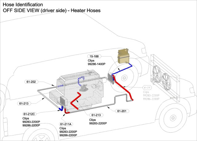

Ahah - I have it tee'd into the blue 61-214 pipe, so its circulating the wrong way as I thought, well actually the right way but via the header tank & everything else etc, , mighty effective going that way haha
Well swapping it around the other way is no goer, it appears this is not the way the heater system works, back to the first method I think.
Just to clarify: It appears not to work pumping into the block first - the flow route suggested by the diagram.

Are you not disconnecting the heater matrix then ? But rather pumping heated water thru the entire system ?

Would you not be better taking the feed to your heater from the engine side of 61-213 and then feeding your heated water back in at the same point but going to the heater matrices? That way engine pumped coolant would flow thru your heater in the normal driving mode, but then when you stop and fire up your heater the hottest coolant would go straight to the heating matrices directly ?

g8dhe wrote:Would you not be better taking the feed to your heater from the engine side of 61-213 and then feeding your heated water back in at the same point but going to the heater matrices? That way engine pumped coolant would flow thru your heater in the normal driving mode, but then when you stop and fire up your heater the hottest coolant would go straight to the heating matrices directly ?
Yes!
This is the next plan, involves some longer pipework but now having worked out whats actually going on this should work well.
Any engine heat will reduce heater usage - I can turn it on, it automatically circulates the water & will turn the burner on when water temps drop below 60deg. Hopefully I can get it to work though there is always the issue of path of least resistance.
Just ordered some new T pieces & pipe

Geoff wrote:Would you not be better taking the feed to your heater from the engine side of 61-213 and then feeding your heated water back in at the same point but going to the heater matrices? That way engine pumped coolant would flow thru your heater in the normal driving mode, but then when you stop and fire up your heater the hottest coolant would go straight to the heating matrices directly ?
Might this not miss a trick though. First, if the Webasto pump is able to pull coolant around the whole system, it will be able to take legacy heat from a hot engine and use it to good effect by passing it through the rear heater matrix. Then , when its thermostat tells it to light the burner, it will be able to invest heat back into the whole engine block so that it can in turn black-body / conduction radiate gently heat into the cab via the central engine cover area. Also, a small low capacity circuit is more likely to cause the system to 'hunt' as the volume of coolant requiring heating is much less and the thermal mass of the body to be heated is much less also, so that the thermostat may be forever switching the system on and off.

The heater pump "sucks in" from the left hand side small pipe by the alternator into the heater & out via a pipe that feeds & tees into to the rear heater matrix "input"
Its using the original header tank which is handy, I'm using an original Rover 75 heater output pipe which has a handy bleed valve on top which is just in the right place for this job.
If you wanted to just pipe to the heater that would work fine but you would need a remote header tank for the system.
