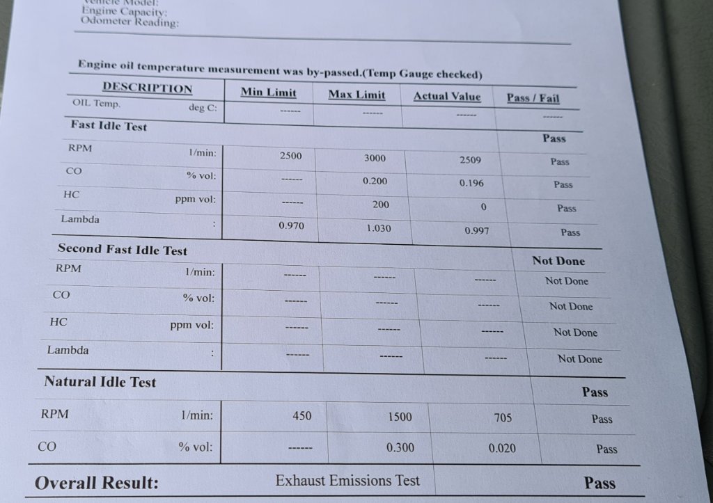

Hmm, this year MoT station merely gave me a "NON-CAT VISUAL CHECK":
Whereas last year, when I justified use of "Minibus limits", same station gave me "NON-CAT METERED CHECK":
After having first failed it on "CATAYLST EQUIPPED WITH CLC":
Only 12 days ago, so reckon I'm going back to demand a full CAT-TEST but with MINIBUS LIMITS (which I thought I had, grrr)

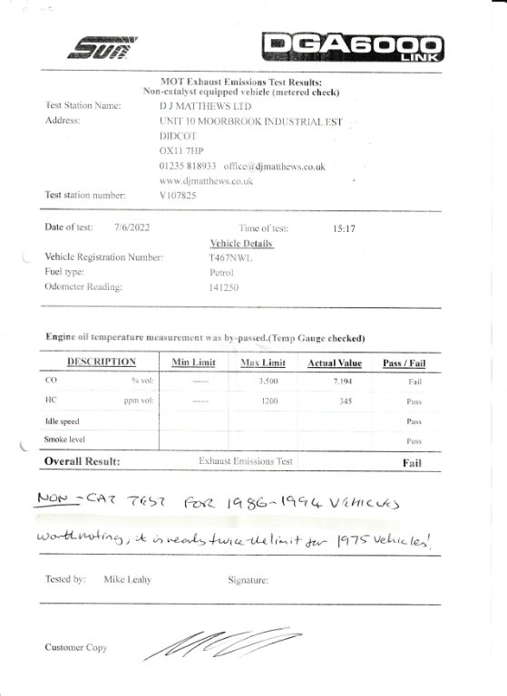

So, My V6 Petrol also failed on one thing at his yearly heath-check. Seems to have gaseous emission problems - much like his owner.
It had a mini service when I got it in June last year comprising of new plugs, new HT leads.
I fitted a new air filter in April this year where I also cleaned the MAF sensor.
It had a cambelt service about a month ago where it also had an oil change, oil filer etc.
When it failed with such a big reading I fitted a new Lambda sensor, no change even when nice and hot. (I have a little Gunson gas analyser which gave the same reading as the MOT station).
Any suggestions on where to head on the diagnostic trail next ? All input welcome.....
Fail Cert
Fail Cert
