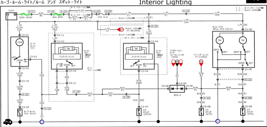

Here is the diagram for the lighting circuits;
