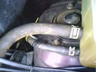

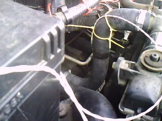

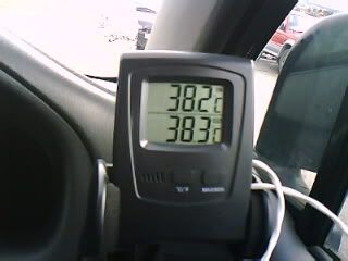

Update on Experiment 1
Cos there was a lot of white stuff around this morning I was running the engine while clearing it. When I got in I noticed that the expansion tank hose temperature was slightly above that of the top hose – not by much - 1½ to 2 degrees.
The usual queue on the way to work wasn’t slow enough to watch for any length of time but when I got to work and parked I watched the readings for a while before switching off.
I assume because of the cold weather the hoses had not warmed up as much as yesterday and they were both still below 60. The refresh time of the two channels is not the same and also quite slow – I think for power saving as it only runs off 1 AAA cell.
However, on average the reading for the tank hose appeared to be leading the top hose reading.
See also the readings I posted at the end of the first run – the tank hose is a couple of degrees above the top hose.
Now are these observations a function of the hose diameter, or something,
- or is it a tantalising clue?
If the white stuff holds off over lunch I may get the chance to refine / adjust the method.

Experiment 1.1
revised method
moved the tank hose sensor to the smaller 'in-coming?' hose and used self amalgamating tape to try and remove wind chill effect.
Let it idle for a while - initially the tank hose was one step ahead of the top hose but by the time I switched off the readings were
Questions questions questions
I'll see what I get when I head home tonight.
Regards Grahame

Grahame, where did you get that 2 channel thermometer from? I'm looking at buying / making something similar & would be interested to find out. Thanks

Simon,
£7 from our local garden centre - Its a Gardman or is it Gardmon? inside/outside temperature monitor.
It uses glass bead therminstors, one on a length of wire and one mounted on the circuit board. I removed them both and fitted them on long wires.
I was trying to find a cost effect method of getting temperature measurements when I found this at the weekend. I think its brill for the price - saved me a lot of messing about.
Only thing is I'm not sure what the max reading is - when I tested it out before I changed the cable every time I put it in the boiling kettle it went to HH.H. that may be because of the water shorting the wires though!
By the way it has min & max readings accessed by the right hand switch - could be useful.
Regards Grahame
