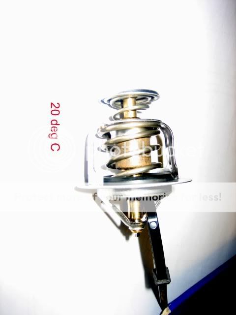

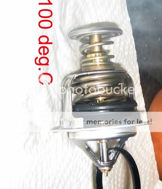

waycar8 wrote: From what I could gather the cone shaped pin or tapered pin doesnt come into contact with anything does it? as its located in the middle of the stat to either open or shut the base of the stat:? as you said a "piston" so wether its a cone shaped or just a pin type I would have thought the outcome would be the same unless theres something inside the cone shaped piston other than wax ect, but will hold that thought till you have disected the mazda stat ect :wink:
Bit hard to understand unless you have seen one opened up. The brass bits are the cylinder - not the piston.
Examine these 2 images, which are the Blueprint stat. No rubber bit and no taper, but in other respects, the same as a Mazda stat.
On both pics, you can see the brassy coloured bits - those parts are effectively all one piece which is the cylinder.
The smaller diameter, shiny steel bit, just visible, is the piston which is static - fixed to the cage.
If you now look at the 100 deg pic, you will see the stat lifted, exposing the static piston.
I expect the Mazda stat to be similar, with the exception that black seal, which the Blueprint doesn't have, will behave as a seal between the shiny piston and the brass cylinder. That's what I'm expecting, but as on so many previous occasions, the Mazda stat may have yet another little secret to share - once I have opened it up. :twisted: :twisted: :twisted:
Steve
