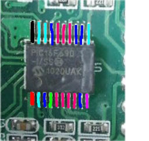

Though I still don't have a unit to play with, I loaded up the HEX that bikerbob sent me into PIC Simulator IDE and started to get a bit more from it.Driver+Passengers wrote:I'm still going to pursue the software approach, but it will mean that the threshold is pre-programmed.
RC0:7, RA0:1, RA5 and RB7 are given over to the LED display. Pin1 is power, Pin20 is GND, and it must be using an internal oscillator. That's 14 so far, leaving six. AN2:3 and AN9:11 are configured as analog inputs (5) and RA3/MCLR is digital input.
[*] Red/Black: power
[*] Cyan/Magenta: LED enable/segments
[*] Blue: analog in
[*] Green: digital in
I'm a bit hazy on the precise role of each of the blue/green pins. AFAIK, inputs are light sensor, temp sensor 1, temp sensor 2, 4x DIP switches (multiplexed through resistor network?). Any filling in of the gaps here would be appreciated, or indeed a broken unit (happy waiting).
So it will be tight - but probably no reason why you couldn't for example multiplex the light sensor and buzzer onto the same pin.
[Edit: PIC datasheet here]
Re: DIY non invasive temperature gauge probe placement ideas
It's a difficult board to follow with the surface mount components obscuring tracks. I tried taking photos, but either my camera or photography skill is not up to it. It may not have helped anyway as I suspect it may be a 4 layer board as the CH2 input appears to go across R18 and C11 (in parallel and connected to the ground plate) then onto a dead end, with nothing on the other side of the board.
The only one of the blue or green pins I can trace is pin 13 which seems to go through a resistor to the middle 7 seg display unit.
Other than that, pin 4 is very difficult to trace beyond the component you can see in your photo. The rest all appear unconnected, but may well have tracks obscured by the PIC or by the 7 segment displays on the other side. You are aware there are 4 7 segment displays?
I'm not sure that the LDR uses an input - I think the brightness may be controlled by an analogue circuit. It appears to go through a resistor straight to one of the 7 segments.
Sorry it's not much help, but it's the best I can do at the moment. I may have a bash with a multimeter later.

Thanks for having starting this - some interesting points there to note. Pending success with bikerbob's replacement, I may be getting hold of a unit shortly. (Cheers, Bob).tallbongo wrote:It's a difficult board to follow...
The segment/decimal-point lines I believe are shared between all digits, with individual enable bits for each digit. (In my simulator, there appears to be some sort of anomaly with the second channel (?) where it enables two of the digits simultaneously. Or maybe I've got pin assignments wrong. What's worse though, is that it clears the segment lines before the enable lines, which means the simulator can't latch the digits as it thinks they're actually cleared. But basically, each digit is strobed in turn and persistence of vision makes them appear constant.
.hex! You need to disassemble before getting the assembly listing!!tallbongo wrote:What form do you have the code in? Please don't say assembler!

Started checking board with multi meter. Findings so far
7 seg displays – commoned as suggested.
Pin 1 Vcc+
Pin 2 - can't find any connection to 7-segs.
Pin 3, 4 high resistance connection to DIPs - changes upon switch position, but not in a binary manner (still investigating)
Pins 5, 6, 7, 8 7 seg displays (through 220 ohm)
Pin 9
Pin 10
Pin 11
Pin 12
Pin 13 Ch1
Pins 14, 15 and 16 7 seg displays (through 220 ohm)
Pin 17 Ch2
Pin 18
Pin 19
Pin 20 Gnd
[*] Blue: analog in
I'm a bit confused by this and your latest post where you claim pins 2, 10, 18 and 19 are the enables. I think 10 should be cyan and 11 some other colour - it's connected to the LDR.
Anyway here's an update.
Pin 1 Vcc+
Pin 2 – no connection <200K to any 7-seg pin
Pin 3 Dip 1,2,3,4 – see below
Pin 4 Dip 1,2,3,4 – see below
Pin 9 – Dip 3,4
Pin 10
Pin 11 - LDR through a 7K resistance.
Pin 12 Dip 1,2
Pin 13 Ch1
Pin 17 Ch2
Pin 18 - no connection <200K to any 7-seg pin
Pin 19
Pin 20 Gnd
DIP switches 1,2 commoned
Both On – 6K to pin 3, 15K to pin 4
1 on, 2 off 7K and 16K
1 off, 2 on 7K and 16K
Both off – 14K and 21K
Dip switches 3,4 commoned
1 on, 2 off – 8K and 17K
1 off, 2 on - 7K and16K
Both off - 12.8K and 20.6K
(all resistances approximate as they are hard to measure on such closely grouped pins)
I've not measured all the 7 segments – 10 pins on each giving (10x10x10x10) is a lot of combinations! However they do seem to be reasonably consistent, but not all. The non-consistencies are probably enables and possibly the top segment you are having problems with.
The small 7-segment which only displays the sign seems to only be connected on one segment. It make sense that this is the middle segment and it is connected to pin 5. Hopefully this is consistent with your findings.
Assuming 2, 10, 18 and 19 are the 7 seg enables and are only connected when powered up, this agrees pretty well with the coding.
The only mystery is pins 3 and 4 - clearly related to the DIPs and hopefully the code will help out here.

The enable pins probably go to the transistors. If LDR is through 7K, to which pin is the 7K/LDR junction attached? I'm assuming its a voltage divider read by analog pin, and energised by a digital output pin.
With that many pins used for the dips, I think we're on to a winner!
Driver+Passengers wrote:The enable pins probably go to the transistors. If LDR is through 7K, to which pin is the 7K/LDR junction attached? I'm assuming its a voltage divider read by analog pin, and energised by a digital output pin.
