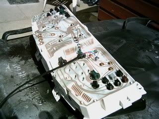

fitted cable supplied by dave mason to back of clocks,following his instructions as to which colour wire goes were. red is on IGN, green is on E and blue is on "TU".sorry for the unclear pic

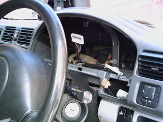

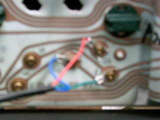

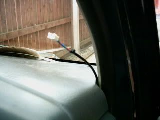

rourted cable through back of dash,and found enough space at side to feed cable through,waiting to attach alarm unit,took around 10-15 mintes to complete,and this is the first time i have ever removed clocks on a bongo
