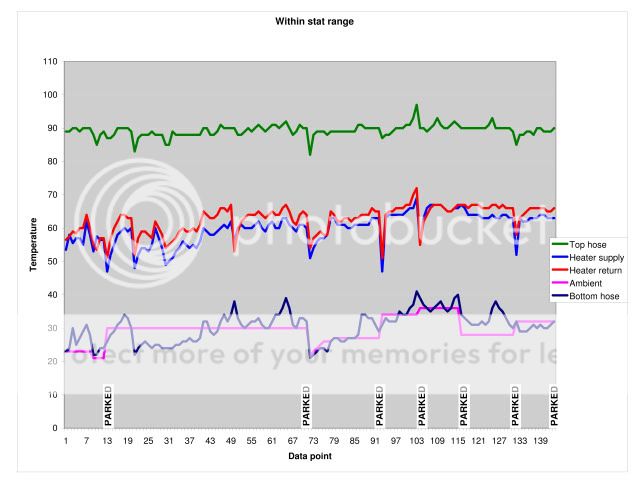

Your comment 'My point about the stat is, I realise it helps the engine get up to temp, but as it appears from other posts, if its just a little bit faulty then its a block in the system so why not try running without' - yes, no doubt whatsoever that it will keep the temperature down - absolutely NONE - but by doing this, you are kidding yourself that the problem has gone away....and it aint - it's just sitting there waiting for another fault to occur and then it will jump up and bite you (and it has potentially very expensive jaws)
