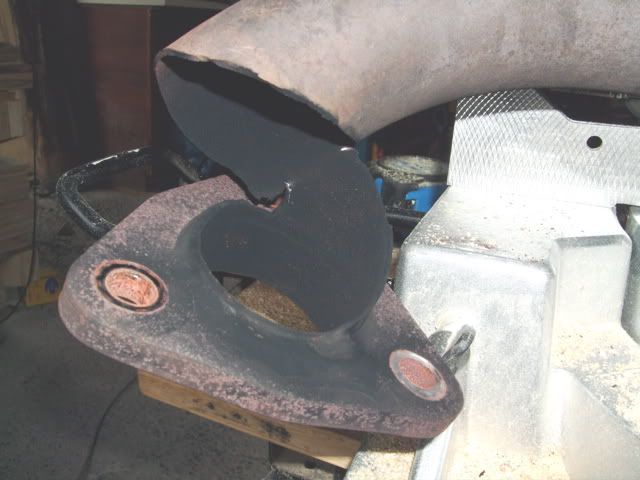

More than just a little blow...
To fit the new pipe, I've got some Holts Firegum (hard setting, self-sealing lubricant) to seal the two joints either side of the winter pack exhaust flap thingy. There was nothing there when I removed the old pipe, but figured it would be worth making sure it went back together fully sealed. Don't need any at the front of the pipe, as I have a gasket ring for that.
