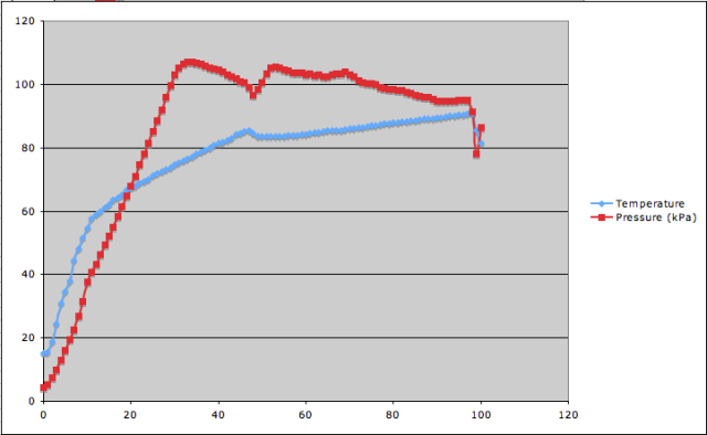

Starting with a small +ve pressure in the system (0.6psi), I ran the van at idle until the rad fans came on. Here is the graph, though note I have displayed the pressure in kPa to improve the scale relative to temperature. The highest recorded pressure relative to yesterday's atmospheric reading was 15.5psi.

I suspect the drop in temperature at 50 minutes (when the stat opens presumably) is a combination of a bolus of cold-ish coolant from the bottom hose and the fact that the radiator was cold and removes heat from the coolant until it gets up to temperature.
I can't explain the gradual drop in pressure from 30 minutes onwards, perhaps hoses expanding. Thereafter, I'm assuming that as the stat opens further that there is an effect of introducing more flowing coolant into the system. Possibly also hoses expanding, though this would have to be due to temperature, not pressure.
This was a no-load test. Other that the cold start and fast-idle when the rad fans kick in, it was sitting at 800rpm, or thereabouts. The +ve pressure in the system at rest I think was to do with the fact that I had performed a minute at 2k RPM yesterday - the hypothesis being that I had introduced additional exhaust gas into the system at that point and it had not vented. During this evenings test, it may well have been the case that I wasn't running hard enough to open up whatever cracks or fissures there may be in the head/gasket.

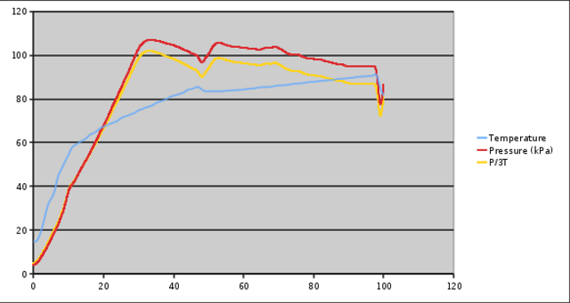

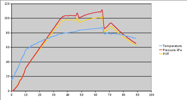

tallbongo wrote:I think you need to look at the rate of change of the ratio of the two parameters. I suspect that at 36 mins the coolant is up to running temp and has pretty much finished expanding. P/T is only constant when V is constant.
Plot P/T (remember to convert the T from deg C to K) and I think you'll find that this ratio approaches a constant with a marked flattening of the curve between 30 mins and 40 mins. I had a go at this, but your plot will be much more accurate as you have the raw data.
Duly done, for both test runs. Note: I've adjusted scale of P/T to P/3T, and pressure is in kPa.
Image Image

That looks pretty much as I'd expect. Volume expansion of the coolant up until around 35 mins then a flattening off until the stat opens just before 50 mins (changing the total coolant volume in circulation).
The only thing that I don't understand is when you used the heaters/aircon at 65 mins. How good is the 5V supply, as your pressure meter output varies with Vs (Vout = Vs x {0.002421 x P – 0.00842})? I'd assume that there would be voltage changes (on the 12V side) when you start using the heating system.

If that second test was "no load" or "low load", is it possible that I simply wasn't charging the water jacket with gas? If I'm not raising combustion pressure sufficiently to open up any crack/fissure then the system should behave like a healthy system, imo. I'm going to defer judgement until I've revved it, and taken it out on a road test. What do you reckon?
