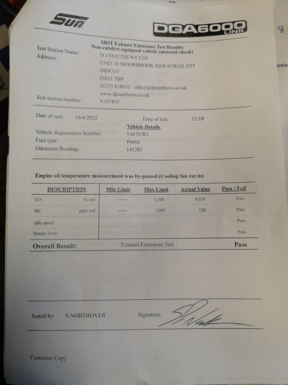

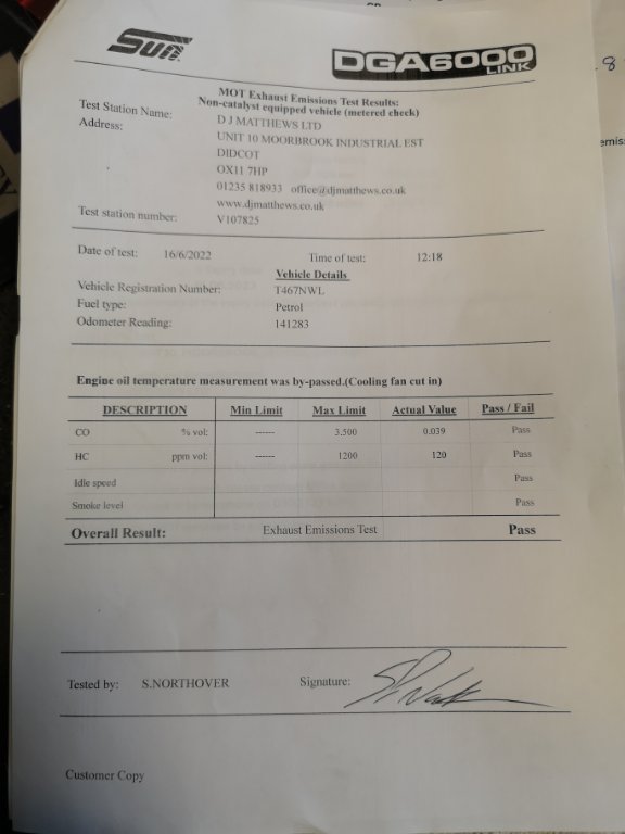

New CAT and new 2 Wire Engine Temperature Sensor.
CO reading down from 7.194% to a more respectable and passable 0.039% !! I think it was the combination of the above / temp sensor causing over-fueling which blocked the CAT. I have some very useful tools now should anyone else need to attempt the same
