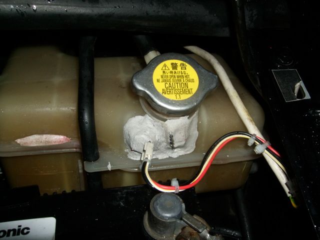

Arg! I've just fried two pressure sensors (£8 each) by connecting the pins the wrong way round.
Still, the third has now been epoxied into a small hole in the front of the header tank, just below the cap. Fingers crossed it doesn't blow out, or get soaked in coolant. I'll take the necessary to attempt a repair in the case that I'm left with a compromised header tank.

Double arg!!!
I thought I had fried the third sensor but turns out I had epoxied a duff sensor onto the tank! I tested them on the bench but they looked very similar, no excuse really.
So, behold... FrankenTank!
Some waterproofing is in order before I drive. And I'll get the hairdryer onto the epoxy too - 10 minute cure but not to full strength, and not in this weather.

But as always, every time I change something, it raises more questions. Like how good a seal have I got around the sensor with the putty? Answer: not very good.

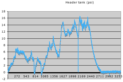

Summary:
800 - stopped to apply more putty.
1000 - stopped to apply more putty and have a cuppa
1500 - got onto motorway
2100 - repeated acceleration from 50-60
2400 - home
2700 - 0psi - that's less than half an hour
