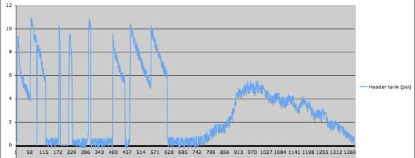

For what it's worth, today's readings...
The rise to 9psi at around 680 was nailbiting. Temp gauge started creeping towards what I know to be 90ish, but creeping rather fast. I said to the boy "I think we have a problem, oh no!" to which the 4yo replied "have you got all the tools, daddy?". (I'm not sure, is it even legal to get him to step on the accelerator until the needle's pointing at the 3 and hold it there for a minute or so??? :shock: We didn't have to find out.) Anyway, it dropped again of its own accord. I'd been parked at Tesco for about 20 minutes and I think something worked its way out in the first mile or two after that. :(

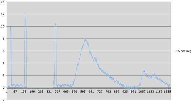

I've isolated a point in time on during the first of the two long runs where I was up to 60, slowing to 45/50 odd and pushing back up to 60 again.
The total time for this trace is 2m15s with a sample interval of 5 seconds. You can clearly see the three occasions on which I put my foot down (staying in 4th with lockup), @7, 12 and 16. Then @20, I stopped at a roundabout then pulled away relatively gently.
Two problems with this: I wasn't logging TPS and there was a air/pressure leak from the header tank. The first is covered my the description of what I was doing at the time and it looks like it can be directly inferred from the pressure chart. The second suggests that this trace should probably look worse if I hadn't a leak.
The reason I'm replacing my head gasket right now is more or less as a direct result of this (apparent) behaviour.

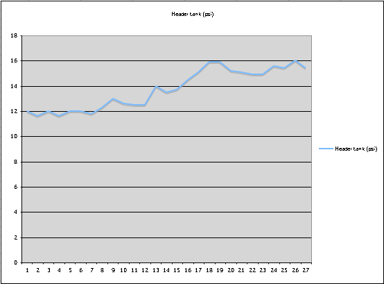

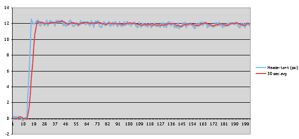

Fitting the sensor to the header tank has resulted in a pressure leak (or perhaps more than one). Combination of epoxy putty and 2-part epoxy still hasn't cured it, so I'm going to refit a sensor to the bleed hose, compare values with the one in my header tank and then replace the header tank with one that hasn't been tampered with.
For the time being, I'm sticking with the MPXHZ6400AC6T1 - just ordered 5 units from Farnell for £27.00 inc VAT. They're -1 bar to 3 bar, which is more than I need but they're cheaper than the lower range options.
After replacing the head gasket (see viewtopic.php?f=3&t=58441) there are no signs of coolant pressure rising under load, so I think I've "fixed" it. However, I need a few more traces to be sure.
Here are two traces since the gasket was replaced that show the pressure leak(s)... cold, static pressure tests on the left, road tests on the right. I've smoothed the second trace using 15 second moving averages (sample period 5s).

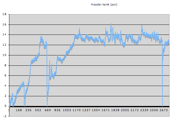

Still leaking, but still driving. Peaked higher this time. Sharp drop at 200-odd represents about 45 minutes stopped.
More sensors should arrive tomorrow, so I can get the bleed tube monitored again and replace the header tank.

your 10 pounds peak looks about right matt. [-o< :wink:

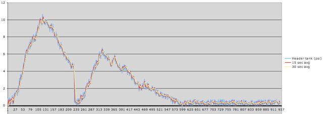

Post by Driver+Passengers » Wed Nov 07, 2012 10:06 am
Cheers, Ady/Mel.
Time will tell...
