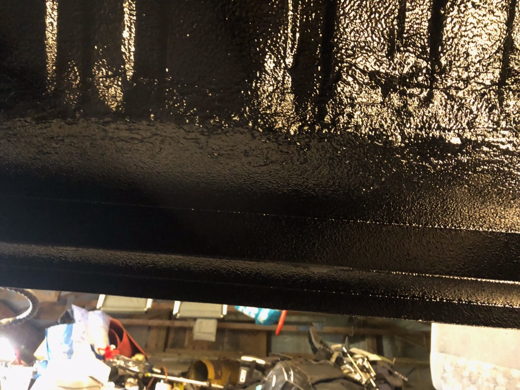

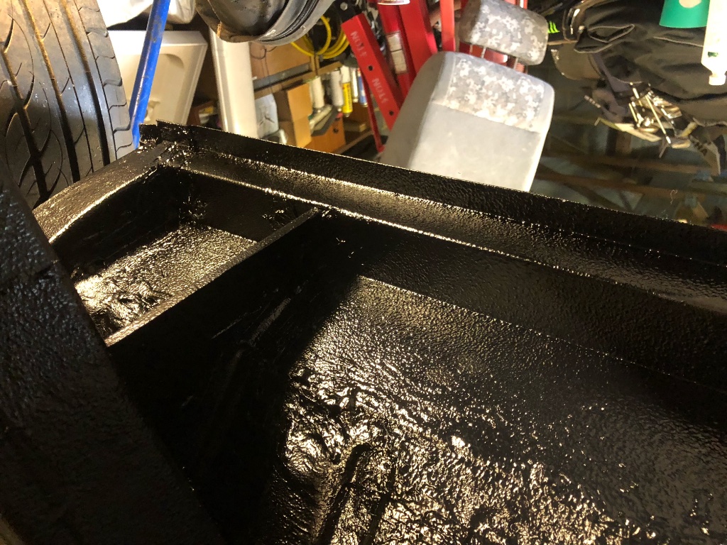

Finished article

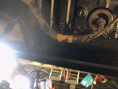

No rear heater or troublesome extra pipe work just extra storage once I’ve lined it out

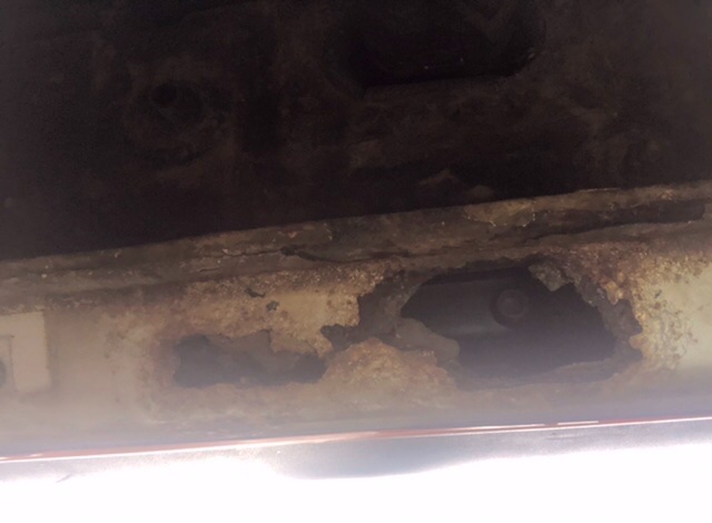

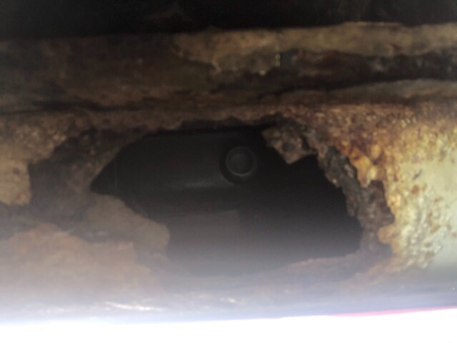

Started stripping off the side skirts of the donor bongo it’s a bit of a warning for people buying bongos with these on outwardly it looked like it would need new arches but once they were off you could see the carnage you obviously can’t take them of to look if you’re buying one but I think a rule of thumb would be if it needs wheel arch repair it’s almost a certainty it will need sill work

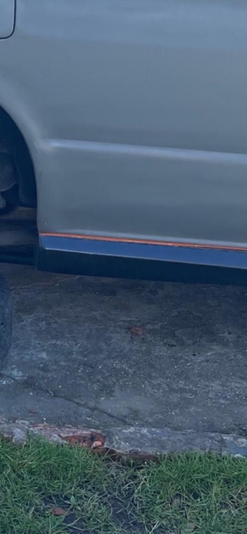

The most recent MOT (October 2022) gave an advisory of rust on the offside front section of the chassis (pictured). Does anyone have any experience with this particular corrosion issue, have any suggestions as to the repair costs and where the best place near to Banbury is to take it to have the work done?
Cheers! Matt. Image
