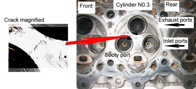

Posts: 10903
Re: Cardiff - Starting & coolant loss problems
Post by g8dhe » Tue Jan 23, 2018 5:35 pm
This is a common place for the cracks to occur;
