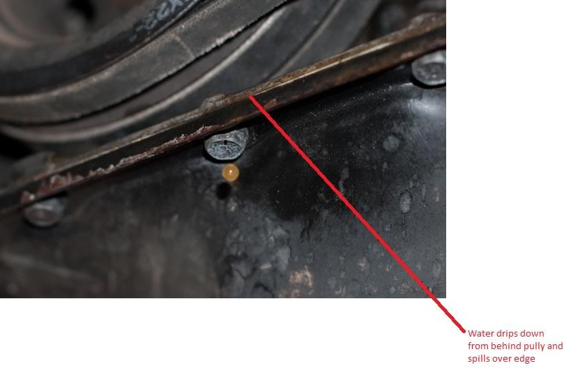

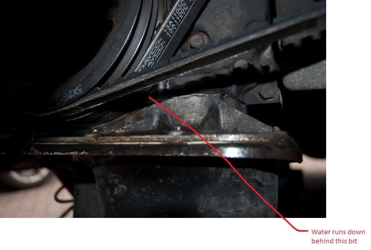

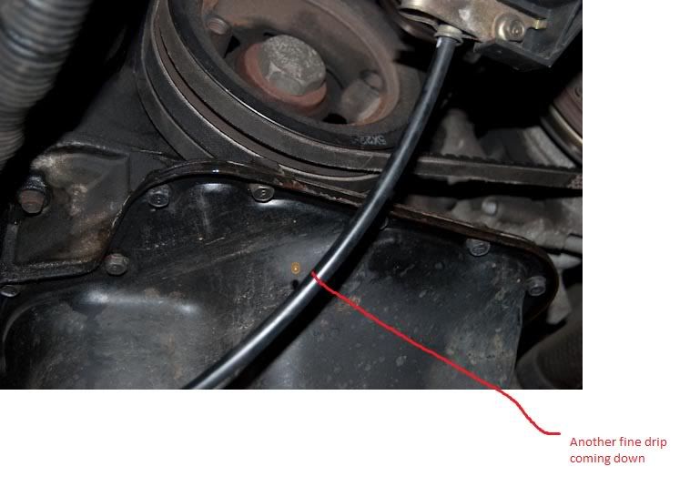

Hi All,
I've read through a few posts now but still unsure on where to start troubleshooting, When I fill up the water/coolamnt reservoir under the bonnet (Top right) after a minute the wate starts to drip from out under the alternator belt area, (The engine is not turned on at this point), I've had a good look round underneath, and the water appears to be running down the crankshaft area and behind the crankshaft pully, it then starts dripping over the edge......
http://i802.photobucket.com/albums/yy30 ... /leak3.jpg
http://i802.photobucket.com/albums/yy30 ... /leak2.jpg
http://i802.photobucket.com/albums/yy30 ... /leak1.jpg
Any help appreciated.....

water pump maybe :(

Might be of some help if it's the pump......

I would have gone for water pump

Most likely water pump.
Genuine ones from Club Shop @ £66, cheaper on ebay but be wary of cheap imitations . . . .

Water coming from that location,could be a faulty(leaking) core plug.

Thanks for the suggestions.....Water pump sounds like a good place to start first...Although I'm not familiar on the Core Plug?
Thanks for the thread link too, I'll post back when I find something more.
