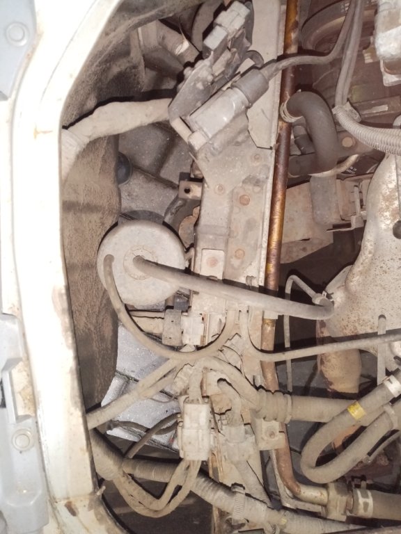

Im looking to fit a diesel heater under the front passenger seat in my 1999 v6 i have looked at the members fact sheet for newshape vehicles but this is for a diesel i seem to have quite a lot of electrical wiring where you normally fit the heater can this just be moved or is it not possible to fit hete on v6 hopefully attached pic

Most people just move the items inboard of the supports I gather see here for various pictures for both 2l and V6

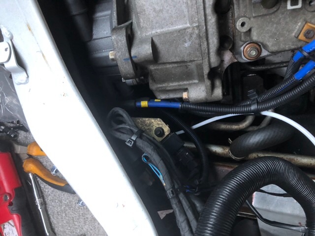

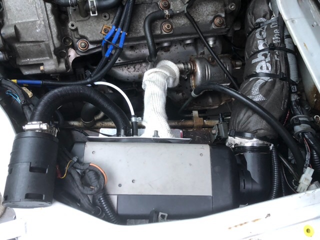

Moved ignition coil as far forward as I could, egr tank as far backwards as possible and wiring a bit. Egr tank needed slightly longer hoses I used standard fuel pipe. If you’re routing your ducting to sliding door I reckon you can just move the tank
